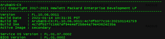

    Posted Feb 22, 2021 12:01 PM
    I am also a bit stuck here. I was having accepts on 6.9.4 but the switch SSH would not connect consistantly and get the multiple server attempts in the TACACS group.
    Now after applying the 6.9.5 patch on CP which included that TACACS+ Fragmentation patch the SSH seems to work but I can't seem to get any authentications in the CP log for the HTTPS sessions to the switch on authentication.
    I am using aaa authentication login default group xxxXXX-T-TACACS local which should send the HTTPS session auths to CP but I am not seeing anything and get an invalid credentials message.
