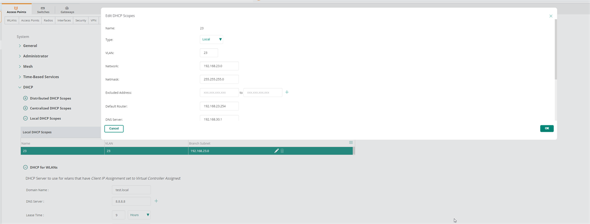

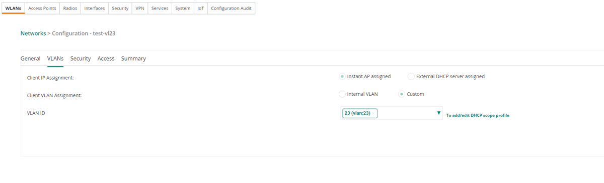

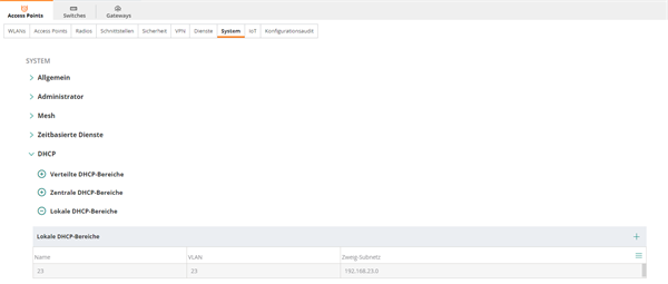

    We would like to configure a second SSID with the instant as dhcp, if we create a new scope under System, dhcp local scpore, and then select it for the ssid under assigned ap and costum, no client gets an IP address from the instant.

    I can only see VLAN 23 info on the screen shots.

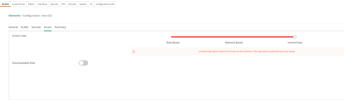

    the ssid is with PSK, the network profile is unrestricted:

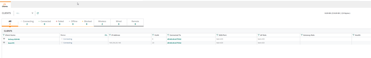

    in the client tap it shows only connecting, the clients says, connected but no internet (get no ip-adress):

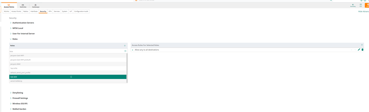

    Would you mind sending me the screenshot with the role please.
    GroupàConfigàDevicesàSecurityàselect role.
    Cheers,
    Ewan.
  • 6.  RE: Central managed IAP dhcp scope problem
    Posted Jul 11, 2022 07:37 AM
    Hi,
    at the moment in my lab there is only 1 IAP, the vlan 23 is tagged on the switchport, a wired Client doesn´t also get an IP-address on an untagged vlan 23 port.
    @Ewan
    Tobias

    it certainly looks like the problem in with DHCP.
    Set the Client VLAN assignment to Internal VLAN instead of Custom and see if Clients get a IP address then - although it won't be on your desired VAN 23.
