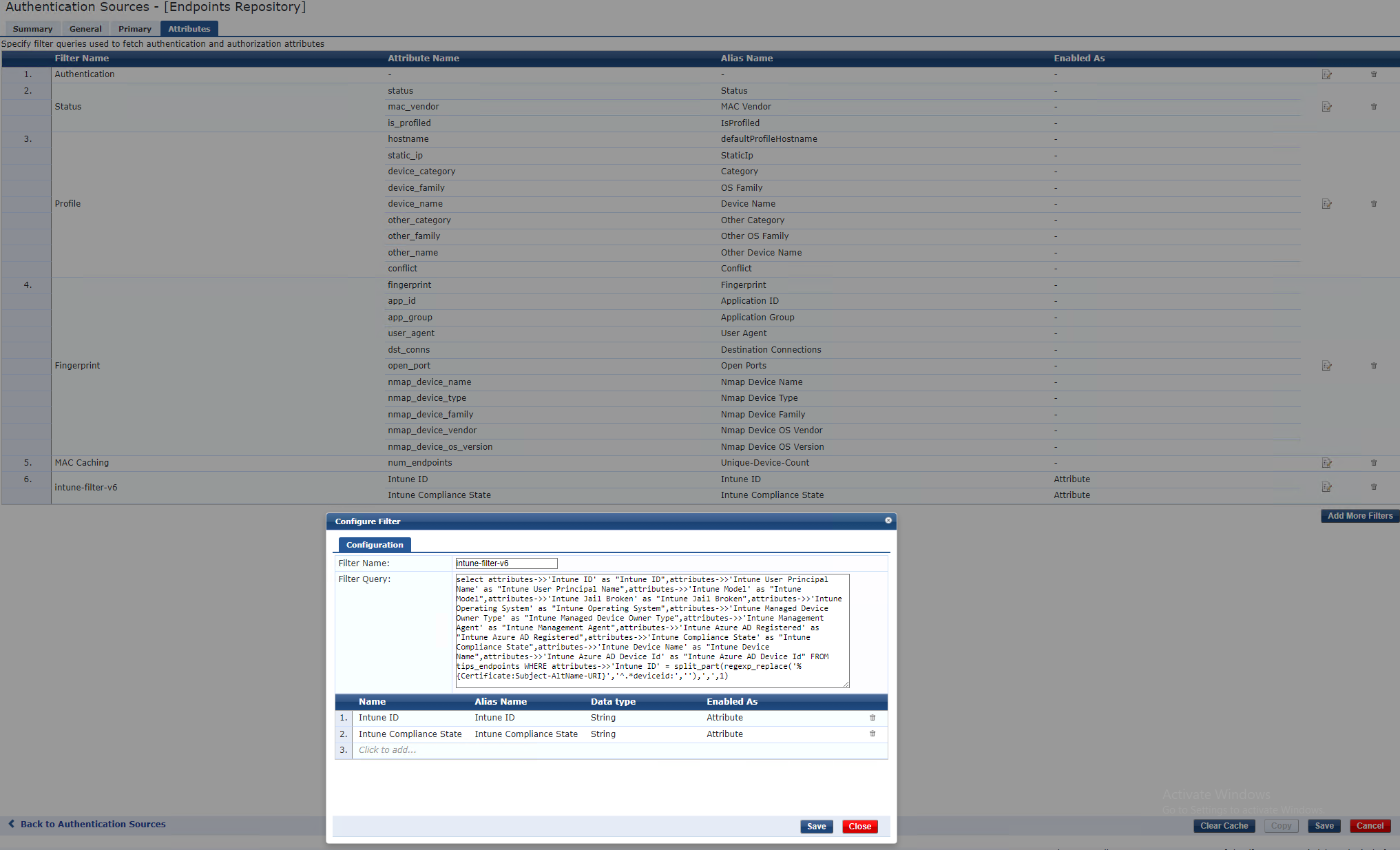

    I've finally managed to get entra-joined endpoints with SCEP cert with the Intune ID in a SAN ("deviceid:<guid>" - I'm using MS Cloud PKI and it's changing the case) and finally realised I had to match the rolemapping conditions with the same authentication, however it only works with the default Endpoint DB, adding as a 6th line. I simply cannot get it to work as a new Generic SQL auth source like so many people have mentioned - it keeps erroring with syntax error. This is what I have now as a basic test:
    This SQL query added:
    select attributes->>'Intune ID' as "Intune ID",attributes->>'Intune User Principal Name' as "Intune User Principal Name",attributes->>'Intune Model' as "Intune Model",attributes->>'Intune Jail Broken' as "Intune Jail Broken",attributes->>'Intune Operating System' as "Intune Operating System",attributes->>'Intune Managed Device Owner Type' as "Intune Managed Device Owner Type",attributes->>'Intune Management Agent' as "Intune Management Agent",attributes->>'Intune Azure AD Registered' as "Intune Azure AD Registered",attributes->>'Intune Compliance State' as "Intune Compliance State",attributes->>'Intune Device Name' as "Intune Device Name",attributes->>'Intune Azure AD Device Id' as "Intune Azure AD Device Id" FROM tips_endpoints WHERE attributes->>'Intune ID' = split_part(regexp_replace('%{Certificate:Subject-AltName-URI}','^.*deviceid:',''),',',1)

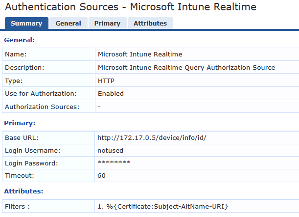

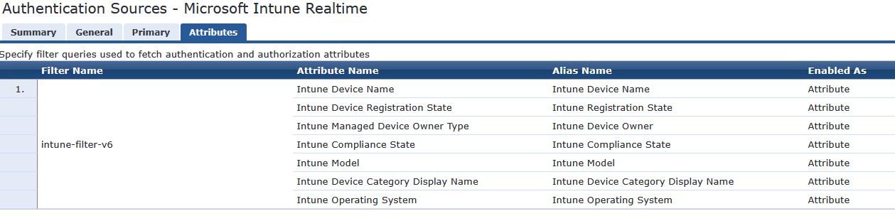

    I have created an Intune realtime authentication source (the IP in base URL is the Intune extension's IP address).
    In filters I have added some useful Intune attributes:

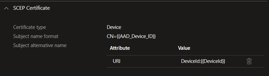

    Here is the certificate profile we use for devices:
    Note however that the CN field is irrelevant for ClearPass authentication, you can set that to anything you want.

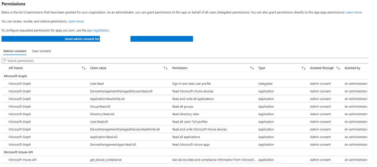

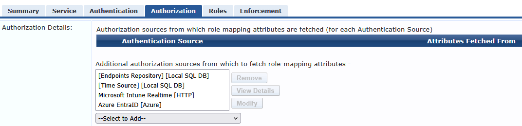

    Use Intune extension 6.3.5 or 6.4 and make sure the Azure application rights are correct! That is a crucial part! Here is our settings but we use it for EntraID too so you may need less rights. Pay attention to the Type! For most rights it should be Application type!
    If you set all of these then just make sure that you add the authentication source as additional authorization source in your service config and you can use the "Authorization:Intune realtime:attribute name" in your role mapping or enforcement rules.

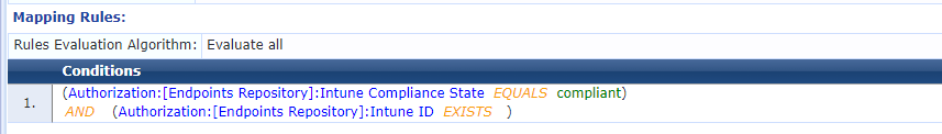

    example role mapping:

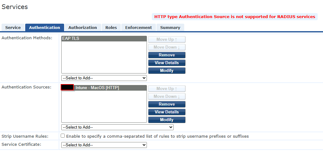

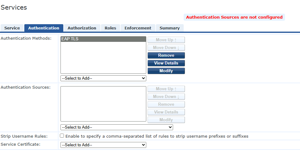

    How are you creating a service without an Authentication source? If I try to do that I get the following:
    And if I try to put in the Intune HTTP source I get the following:
  • 8.  RE: ClearPass - accessing Certificate:Subject-AltName-URI subvalues

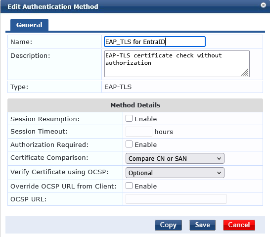

    I think the problem is that you are trying to use the EAP TLS built in authentication Method. Create a new one and disable Authorization required in it.
    This is what I use.
    In the service configuration you can later define authorization sources.

    You will need to define at least one authentication source under the service. Intune http based authentication source is an invalid option.
    Can you share your authentication source section from the service.
