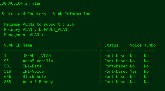

    The VLAN's are definitely on the switches.  There's data, voice, visitor and quarantine VLANs on all switches.  There are 10 switches in this area and all are configured the same and were working previously.  All switches in this area stopped working late on a Friday afternoon at the same time and I had to deactivate the authentication to get everyone back online.  The problem only affects this one area.  I am the only one who normally works on the Clearpass system and I made no changes to the switches or servers that day.  However, others do have access to the system who know even less than I do and one of them may have made a change. :-(  I think it more likely something on the server has been messed with rather than config on 10 switches.

    Can you please post Output tab result from access tracker and show vlan <802.1x vlan> on switch? Behaviour is consistent with wrong vlan value on radius response.

    Hi Gorazd.  Here's the output and I've attached 2 screenshots.  One is when the 802.1x works and the PC is authorised as normal, and the second is when the MAC check then immediately fails it through to the visitor VLAN (95).  Let me know if you need anything else.
    VLAN output

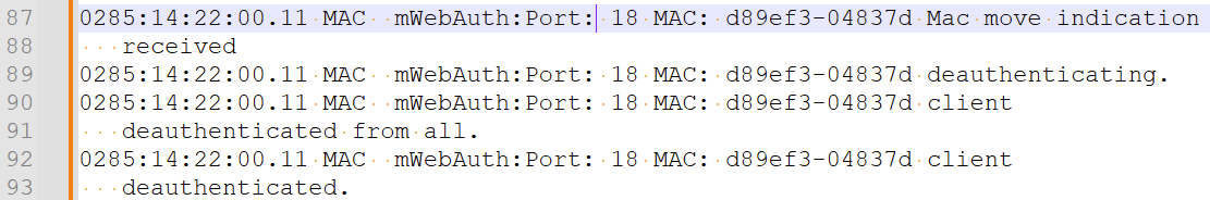

    I see a lot of MAC-moves for MAC d89ef3-04837d. The MAC address flaps between port 18 and Trk1.
    addrmgrmovelist
    mac address     vid    old port   new port   timestamp
    d89ef3-04837d    501      18         Trk1    06/25/25 09:00:42
    d89ef3-04837d    501      Trk1       18      06/25/25 09:02:43
    d89ef3-04837d    501      18         Trk1    06/25/25 09:02:43
    d89ef3-04837d    501      18         Trk1    06/25/25 09:02:44
    d89ef3-04837d    501      Trk1       18      06/25/25 09:04:45
    d89ef3-04837d    501      18         Trk1    06/25/25 09:04:46
    d89ef3-04837d    501      Trk1       18      06/25/25 09:04:46
    d89ef3-04837d    501      Trk1       18      06/25/25 09:06:48
    d89ef3-04837d    501      18         Trk1    06/25/25 09:06:48
    d89ef3-04837d    501      Trk1       18      06/25/25 09:08:50
    d89ef3-04837d    501      18         Trk1    06/25/25 09:08:50
    d89ef3-04837d    501      18         Trk1    06/25/25 09:08:53
    d89ef3-04837d    501      Trk1       18      06/25/25 09:10:52
    d89ef3-04837d    501      18         Trk1    06/25/25 09:10:53
    d89ef3-04837d    501      Trk1       18      06/25/25 09:10:53
    d89ef3-04837d    501      Trk1       18      06/25/25 09:12:55
    d89ef3-04837d    501      18         Trk1    06/25/25 09:12:55
    Can you trace down this MAC? I'm curious why this MAC is also seen on the uplink.

    I took another look at the debugoutput (Authentication debug.txt) that Kenny shared.
    In line 87 it says  "Switch Mac move indication received", the client is then deauthenticated.
    This matches the MAC is flapping between the uplink and accessport.

    Kenny,
    What type of switch is the distribution layer (EUGRAC501)? If it is AOS-S you can you the following commands to check the MAC moves.
    show mac-address d89ef3-04837d detail
    edomtset
    edomtset
    addrmgrmovelist
    Willem Bargeman
    Systems Engineer Aruba
    ACEX #125
  • 26.  RE: Clearpass authorisation flipping off and on
    Posted 18 days ago
    Edited by Kenny_10_Bellys 17 days ago
    Hi again,
    The distribution switches are 8320X 48 port fibre switches running OS-CX 10.14.1000.  The only similar command I found showed detailed output of MAC's on the vsx-peer.
    I've just gone through the logs on every switch looking for a loop and there's nothing in any logs.  Just normal ports going off and on through the week.  Loop protect is on and there's nothing logged in the IMC server either.  The only times I've had a loop it's been by people plugging 2 leads into a phone with pass thru and that basically brought down the entire switch making it easy to see there was a problem.  I'm not getting any symptoms like that or any logs of fibre ports going off and on or changing priorities.
  • 27.  RE: Clearpass authorisation flipping off and on
    Posted 17 days ago
    Can you try to use the following commands on the CX switch to see the mac moves?
    show mac-address-table mac-move
    show mac-address-table mac-move address <mac-address>
    Willem Bargeman
    ACEX #125
  • 28.  RE: Clearpass authorisation flipping off and on
    Posted 17 days ago
    Hi Willem,
    EUGRAC501# show mac-address-table mac-move address d8:9e:f3:04:83:7d vlan 501
    Number of MAC Move addresses : 1
    MAC Address        VLAN   Current Port    Previous Port   Move Count   Last Move
    d8:9e:f3:04:83:7d  501    lag10           lag128          35238        Wed Jun 25 12:59:22 2025
    It looks like it's jumping across the normal connection (lag10) between access &  distribution and lag128 which is the interlink between the two distribution switches (EUGRAC501 and 502).
    The network layout on our site was designed for resilience and uses dual cores to dual distribution with dual fibre links to each access switch.  Due to the remote location of this area only a few of the switches have dual link between distribution and access currently.  There are meant to be 4 fibres in the interlink between distribution switches.
  • 29.  RE: Clearpass authorisation flipping off and on
    Posted 17 days ago
    How is the configuration of the lag interface to the access switches?
    Is there something change on that layer? On the other distribution switch, how does the MAC move looks? Which two links do you see there?

  • 30.  RE: Clearpass authorisation flipping off and on
    Posted 17 days ago
    Hi again,
    You are on to something.  We see the MAC on the second distribution switch is flicking between the vsx link to EUGRAC501 and then to port 1/1/10.  The fibre in 1/1/10 leads to switch EUGRAC515 which is on the other side of the docks.
    The only recent work in that area was to install a Wi-Fi bridge to a muster station and emergency telephone.  Our first thought is that perhaps a Wifi loop is somehow being created between this bridge and another on the other side of the docks.  We will run some tests by cutting off connectivity to the new bridge to see what happens.
  • 31.  RE: Clearpass authorisation flipping off and on
    Posted 18 days ago
    Hi there,
    I've just finished going through the logs of all the switches in this area and I can find no evidence of a loop.  There is nothing on our IMC server and nothing in the local logs on the access or distribution switches.  All the switches have loop protect running on the copper ports.  If there is a loop it's not showing in any logs and not causing traffic problems that anyone has reported.  There are a couple of switches in this area which connect through another access switch to reach the distribution (via wireless links) but the rest all link to the distribution via fibre.  Nothing in any logs to suggest an issue.
  • 32.  RE: Clearpass authorisation flipping off and on
    Posted 17 days ago
    So it appears that there is some kind of loop in this network area.  At the far end of the docks is a safety 'muster point' where people have to go during an emergency.  A couple of months ago a Ligowave wireless bridge and an 8-port switch was installed in a cabinet at the point to run a phone and an access control card scanner.  After many assists and pointers from Willem and yourselves I discovered that the wireless bridge is injecting lots of MAC addresses into the network from PC's and devices elsewhere in the area.  This is causing Clearpass to see PC's randomly move buildings for a split second hundreds of times a day.  I believe it's also the cause of other issues we've been investigating such as Teams calls dropping randomly just in this area.
    At this time I have no clue what the actual mechanism of the loop is.  Initial thoughts were that it was picking up a link from another bridge about a kilometre away on top of the control building.  However, the wireless bridges are secured by individual SSID's & passwords and tied by MAC address to each peer unit.  I've also now put a MAC filter ACL on the wireless station to allow only the phone, switch and card scanner but still it's pumping in random MACs from around the area.  More investigation needed!
    Thank you all for your input and assistance.  It has been an education.  :-)
