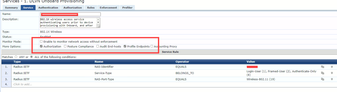

    Hi.
    I'm setup Clearpass Service adding Profiler Endpoint on Service.

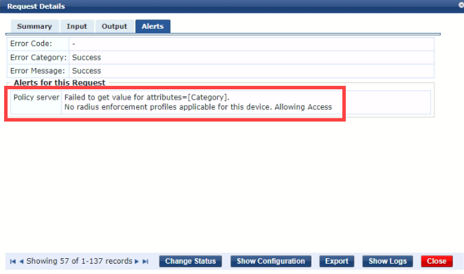

    but on new device firt connect to SSID. CLearpass output Alert Cannot Failed to get value for attributes=[Category].
    When device 2nd connection it is works fine .
    On Switch I Have config DHCP-Relay to Clearpass.

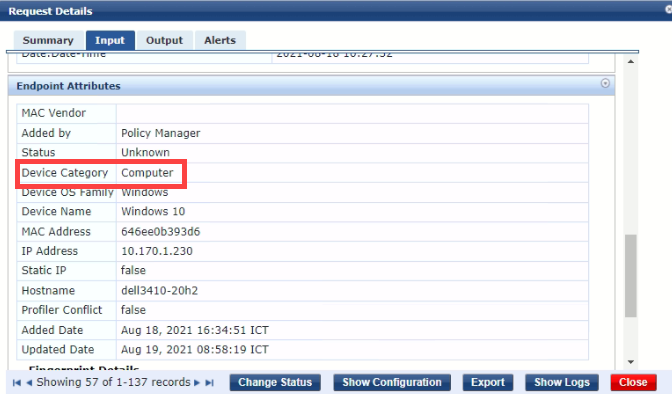

    I don't understand why in the Endpoint attribute there is information that the endpoint category is Computer but the Alert still says Cannot Failed to get value for attributes=[Category]. is this a bug of Clearpass 6.9.0.130064?
    Many Tks
    Le Tan

  • 2.  RE: Clearpass Device Computer Alert Cannot Failed to get value for attributes=[Category]. Althought there is a DHCP-Relay
    Posted Aug 23, 2021 11:05 AM
    Edited by Herman Robers Aug 23, 2021 11:05 AM
    That is exactly what I would expect. At the first connect, there is no profiling information available, and that is what the error message is telling (and thus it is harmless as well).
    After that first authentication, the DHCP relay will share information to ClearPass and will, and should trigger a Change-of -Authorization ([Terminate Wireless Session]). So at the time of the authentication, the profiling information is not there, shortly after it is there, but after the authentication.
    That means the second authentication will have access to the profiling information.
    If you don't see the automatic reauthentication, check your CoA/RFC3579 settings on both ClearPass and your AP/switch/controller, and check with a manual Change Status from Access Tracker if CoA works.

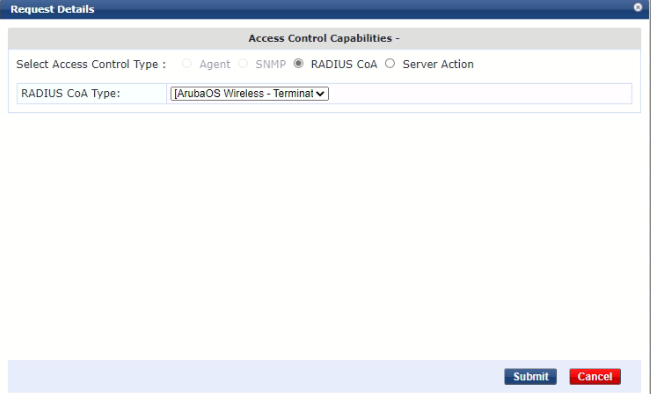

  • 3.  RE: Clearpass Device Computer Alert Cannot Failed to get value for attributes=[Category]. Althought there is a DHCP-Relay
    Posted Aug 24, 2021 03:21 AM
    Edited by Le Ngoc Tan Aug 24, 2021 03:23 AM
    Dear Herman Robert.
    Tks for response.

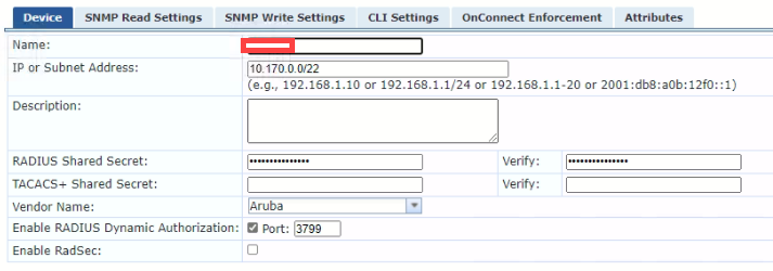

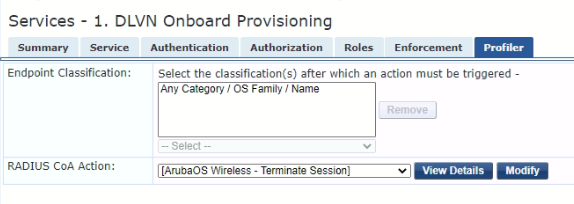

    On Clearpass and IAP i have config RFC 3579.

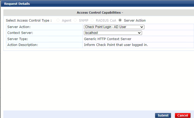

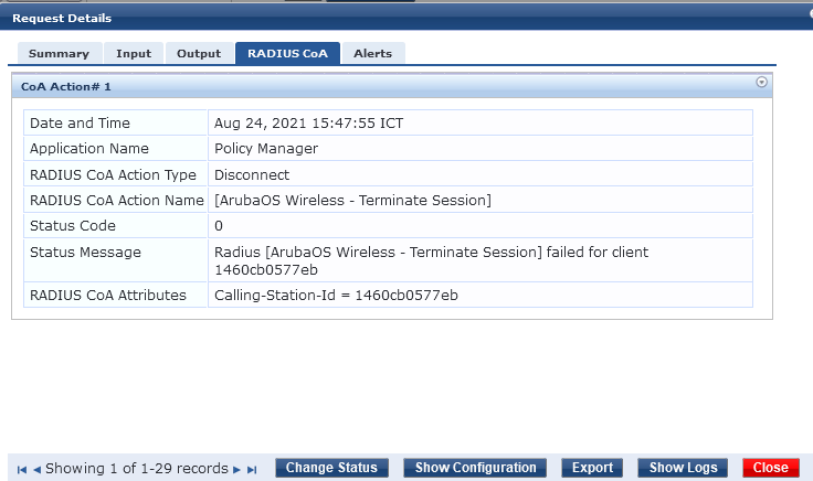

    But on access tracker i don't see tab Radius COA and i can't change status on access tracker manual to Radius COA
    I think Clearpass don't sent Radius CoA althought i have config action is Radius CoA [ArubaOS Wireless - Terminate Session]
    many tks.
    Le Tan

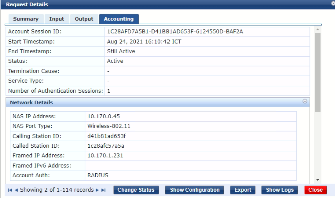

  • 4.  RE: Clearpass Device Computer Alert Cannot Failed to get value for attributes=[Category]. Althought there is a DHCP-Relay
    Posted Aug 24, 2021 03:43 AM
    Did you enable accounting on your SSID? If the 'Change Status' does not offer the Terminate Session there is something wrong with the configuration. What you show above looks okayish, just I think you don't need rfc5997 set (I have it mostly disabled). Accounting is configured on the SSID, not on the RADIUS server.
    This is how CoA / Change Status should look like: https://youtu.be/-5_wdyQmpXE?t=240
  • 5.  RE: Clearpass Device Computer Alert Cannot Failed to get value for attributes=[Category]. Althought there is a DHCP-Relay
    Posted Aug 24, 2021 04:05 AM
    TKs Herman.
    I has turnoff RFC 5997 and enable accounting on SSID. but i don't see Radius CoA Table
    plz check log i attached this message.
    many tks Herman

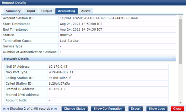

  • 6.  RE: Clearpass Device Computer Alert Cannot Failed to get value for attributes=[Category]. Althought there is a DHCP-Relay
    Posted Aug 24, 2021 04:35 AM

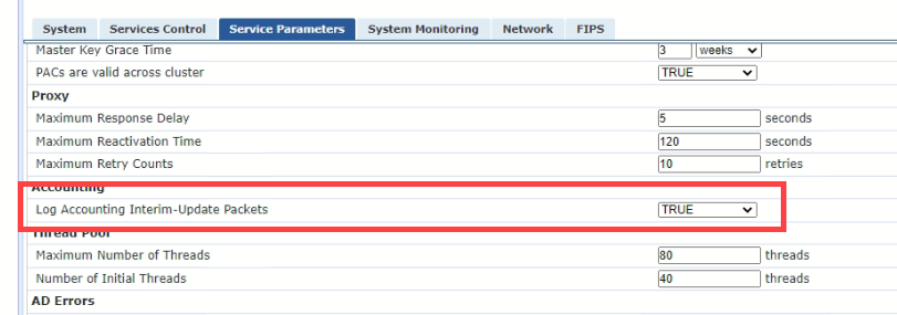

    Can't see from those logs the accounting. Can you check if you have Insight enabled on your ClearPass? And if possible the 'Log interim accounting packets' under the RADIUS Service parameters?
    Do you see the Accounting tab in access tracker? That indicates that there is proper accounting coming in.

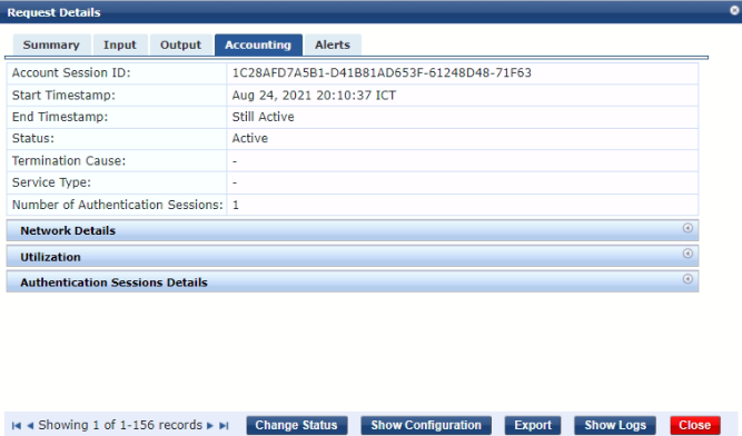

  • 9.  RE: Clearpass Device Computer Alert Cannot Failed to get value for attributes=[Category]. Althought there is a DHCP-Relay
    Posted Aug 24, 2021 05:22 AM
    Dear Herman.
    in Access tracker i see tab Accounting when i turn-on Account on SSID in IAP. but no have TAB Radius CoA.
    I'm not sure where I've misconfigured. Clearpass on my lab working fine, but on customer is fail
    And I enable accounting on Service Parameter all Clearpass in cluster
    Le Tan
  • 10.  RE: Clearpass Device Computer Alert Cannot Failed to get value for attributes=[Category]. Althought there is a DHCP-Relay
    Posted Aug 24, 2021 09:17 AM
    Dear Herman,
    many tks for support.

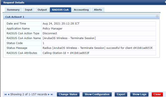

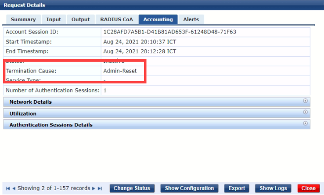

    I'm updated to lastest 6.9 is 6.9.6 and in firts time connect of client, i can manual edit Radius CoA in Change Status Access tracker.
    But Clearpass Still don't Sent Radius CoA automatic.
    After i change manual Radius CoA on ACcess tracker
    Is this a bug and I need to open the TAC Case?
    Le Tan
  • 11.  RE: Clearpass Device Computer Alert Cannot Failed to get value for attributes=[Category]. Althought there is a DHCP-Relay
    Posted Aug 24, 2021 11:30 AM
    If you configured the CoA action in the profiling tab of your service, and manual Change Status/CoA works, but the automatic CoA doesn't, then yes that is not as expected and you can open a TAC case to get that validated.
