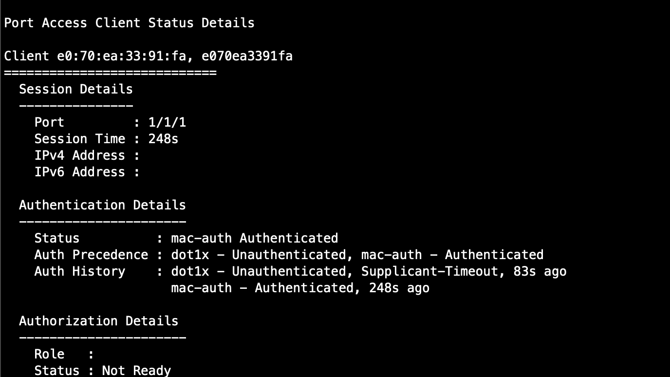

    also check the output of "sh port-access clients" and "sh port-access clients detail" to see why it is failing.

    Hmmm..Getting this error.

    So i change the ACL to port numbers instead of https/http/dns and that seemed to work. stange coz in local user role, when i do the https/http/dns instead of port numbers it still works.
  • 7.  RE: Clearpass downlaodable user role 6300F
    Posted Feb 21, 2025 01:48 AM
    This looks like a difference between CLI parser and REST API.
