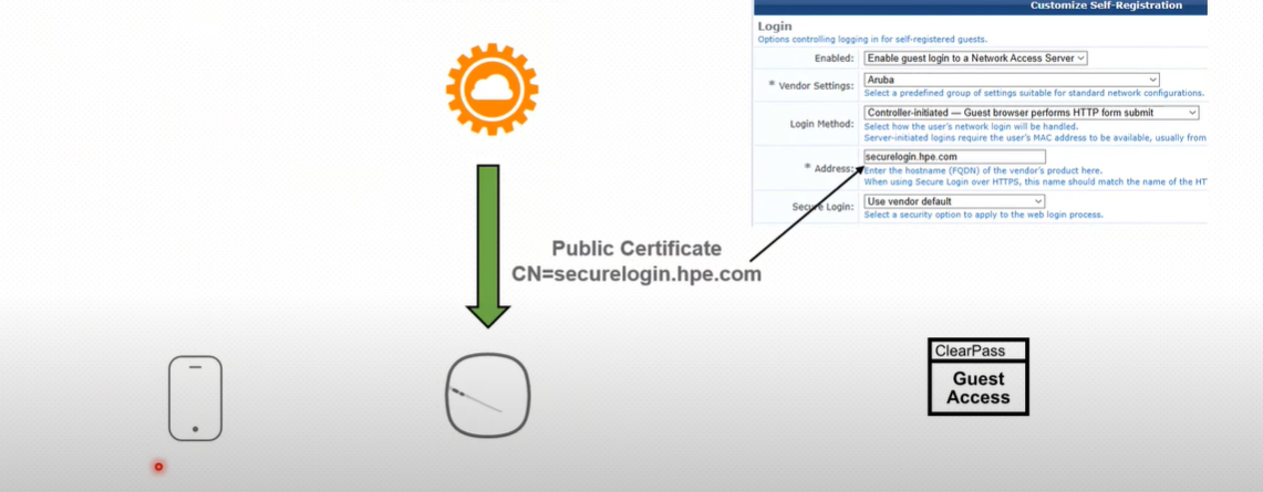

    The FQDN is retrieved from the CN field in the certificate that is installed on the controller / instant AP. AP's managed via Aruba Central will automatically get the certificate securelogin.hpe.com.
    To check the correct FQDN (after installing the certificate) you can use the following commands:
    • Instant / AOS10: show captive-portal-domains
    • Controller: show datapath fqdn

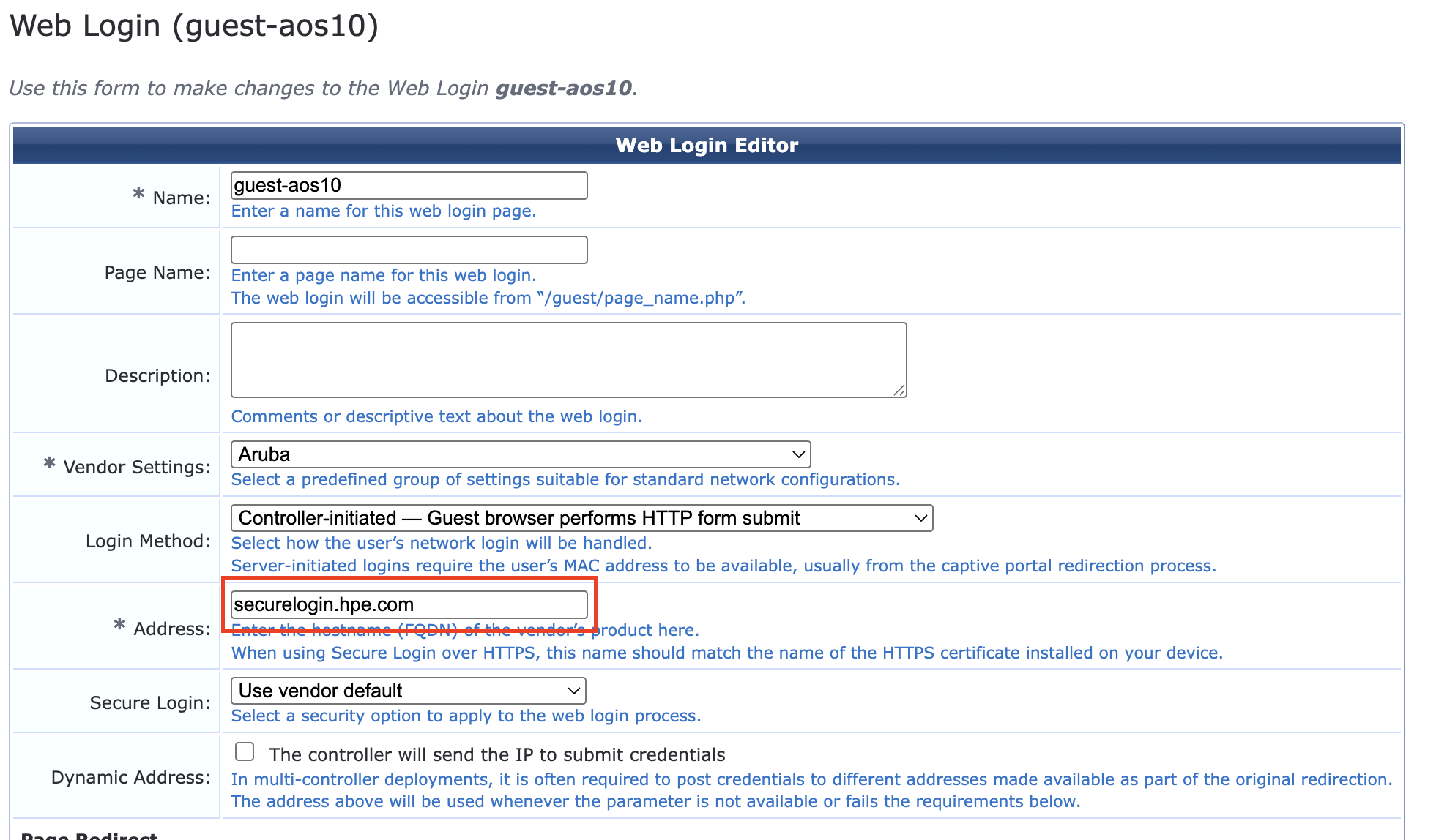

    In ClearPass the config will look like this
    The FQDN in the address field must match the FQDN of the AP / controller.
    Because the AP / controller is in the datapath the DNS interception works. It just simple monitors the DNS requests and if the DNS request is for (in this case) securelogin.hpe.com it will respond to the request and not forward it to the DNS server of the client.
    It's not possible to enable/disable or configure this feature. Changing the certificate will update the configuration.
