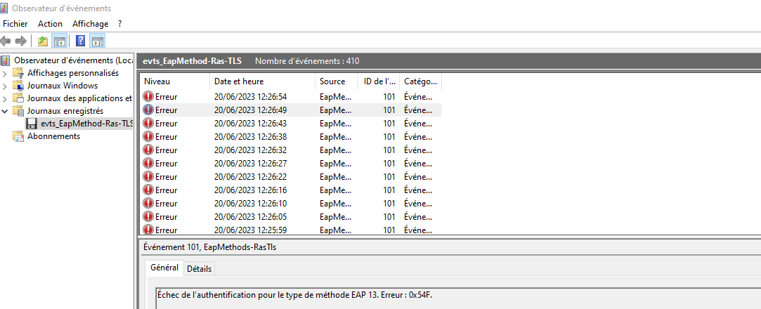

    On the client side we have the error on the rad tls process EAP 13 0x54F
    We take some whireshark capture and see that The serveur send his certificate and the client didn't answer.
    We don't know if it is a bug or a configuration problem ?

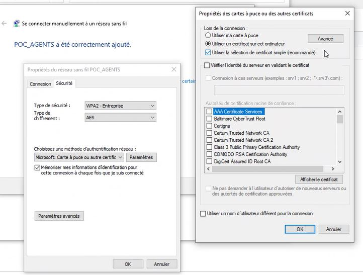

    This is the configuration on the client side for our last test:
    Computer authentication and WPA2 AES
    Thanks for your help.

    The place where you select the trusted root CA looks incorrect.  That should be the CA of the cert for your RADIUS server and not the CA of the client cert.
  • 10.  RE: ClearPass integration with Azure for Intune devices enrollement TLS Issue
    Posted Jun 23, 2023 11:05 AM
    Hi
    Thanks for reply
    We are using the Same CA for Client and Radius Server
    Regards
