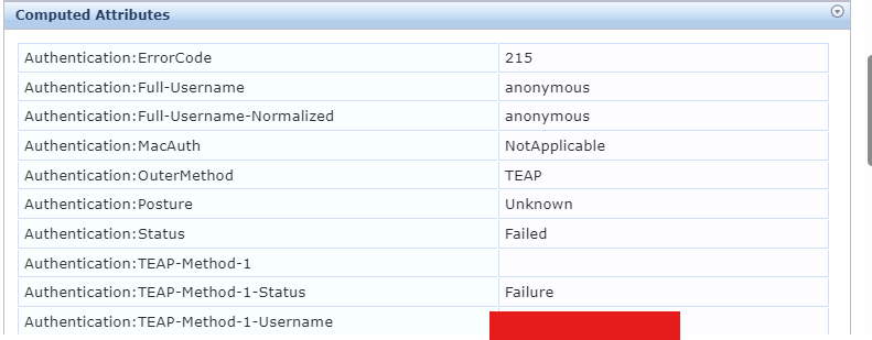

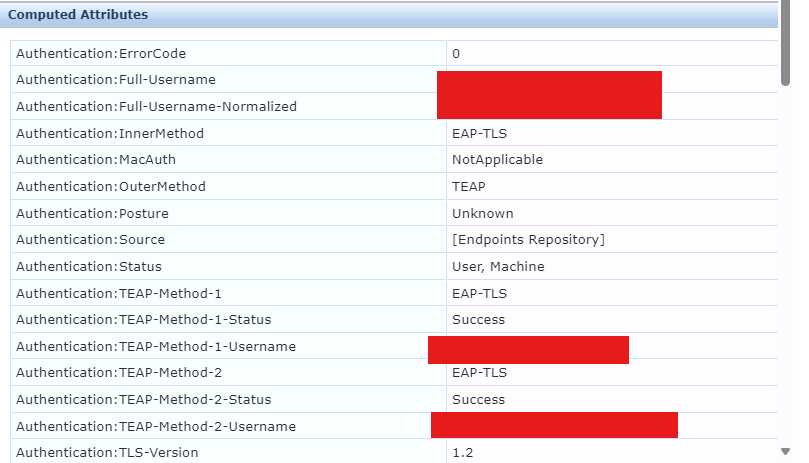

    Is there a way to have both authentication methods enabled for the same service? I tried adding both but I can't seem to make it work. When both auth methods are enabled, TEAP clients can't authenticate. Clearpass gets presented with the wrong credentials, but as soon as I remove EAP-TLS, it starts working. See screenshot below
    Both EAP-TLS and TEAP enabled
    Just TEAP

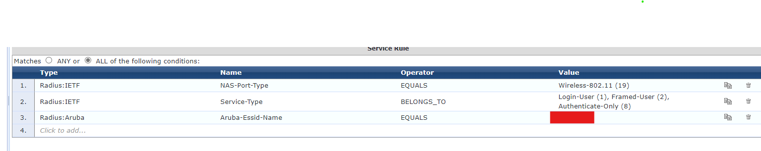

    I thought of creating a separate service just for TEAP clients using the service rules below but now my client can't even connect to the network. I don't even get a hit for this connection attempt in the access tracker logs.

    Do you know why Clearpass is getting the wrong credentials when I have both enabled? On my first screenshot, it only shows one TEAP method, which then fails the session.

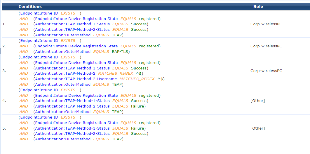

    This is my current Roles Rules:
    And this is my current Service Rules

    I was able to fix this thanks to Zednick from reddit by creating a separate service where the first service has the following rule:
    Radius:IETF User-Name BELONGS_TO anonymous,teap
    And the other service only checks for the SSID.
