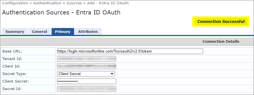

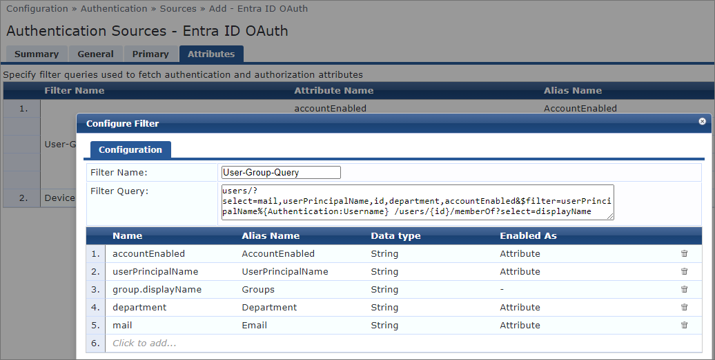

    Hi Herman,
    Thank you for your reply. Entra ID connection seems successful via app registration.
    Please help if attribute query part for Entra ID is correct, as shown below.
    Filter query : users/?select=mail,userPrincipalName,id,department,accountEnabled&$filter=userPrincipalName%{Authentication:Username} /users/{id}/memberOf?select=displayName

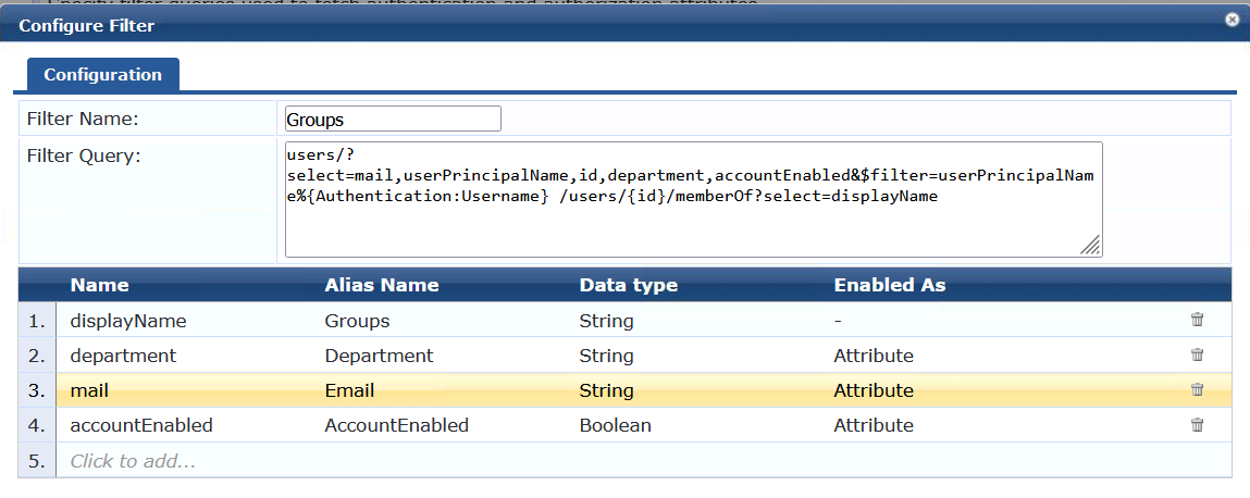

    Are you on ClearPass 6.12?
    There is something weird with that query... where you have the part filter=userPrincipalName, I would expect 'eq %{Authentication:Username}', and the eq is missing, which may be the reason. The screenshot above that you copied seems from ClearPass 6.11 (dated 2022).
    Here are the queries that I use at the moment:
    1. users:users/?$select=userPrincipalName,displayName,id,accountEnabled,companyName,createdDateTime,department,employeeId,lastPasswordChangeDateTime,registeredDevices&$filter=userPrincipalName eq %{Certificate:Subject-AltName-msUPN};group:/users/%{users:id}/memberOf?$select=displayName,id,groupTypes
    2. device:devices?$select=id,deviceId,displayName,approximateLastSignInDateTime,enrollmentType&$filter=deviceId eq %{Certificate:Subject-L};deviceGroups:devices/%{device:id}/memberOf?$select=displayName

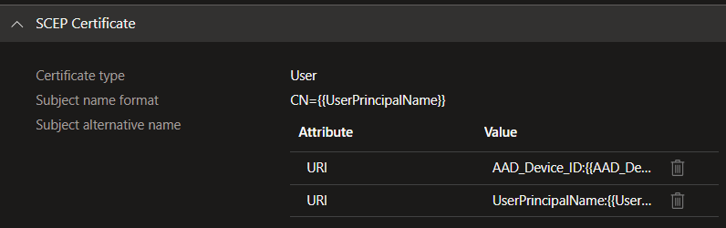

    I am using ClearPass 6.11.9 and UPN is in the certificate Subject Alternate Name.
    User Certificate looks like this. Using only AAD_Device_ID and UPN to fetch information from Intune and Entra ID.
    My experience is that the Azure Application rights are crucial for the proper operation (must be Application Type and not Delegated type!)!
