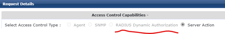

    I am using dynamic authorization in lan and it works fine. In Wifi (controller based) it does not work. Wifi clients have the field for CoA grayed out.
    What are the requirements that this field is not grayed out and the dropdown with the different "bounces" is available for selection?

    For the interim update on ClearPass, I only found this setting, which is set true.
    Unfortunately, the "Radius -Dynamic-Authorization" field in Access Tracker is still grayed out. Any other ideas?

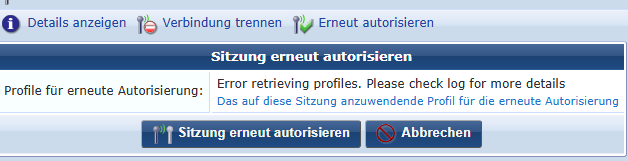

    If I view the same session in the guest portal under active session, it shows me the following:
    (I am currently using CPPM 6.11.11. It was still working a few months ago with an older version. I can't say whether it's since the last update or not.)

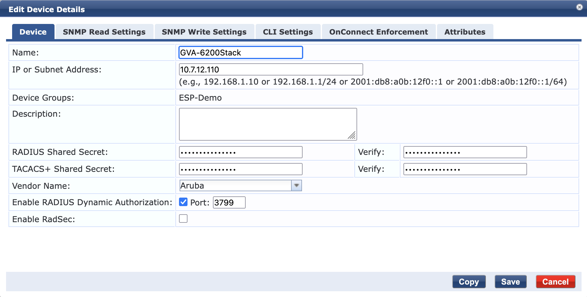

    In that case, please double-check the Vendor Name as configured in the Network Devices:
    It's Aruba for APs/Controllers/Gateways/CX; it's Hewlett Packard Enterprise for AOS-S.  Also make sure Dynamic Authorization is enabled, and the actual source IP and the NAS-IP (if different) are both configured as a Network Device. If that doesn't help, maybe opening a TAC case to find the root cause is best.

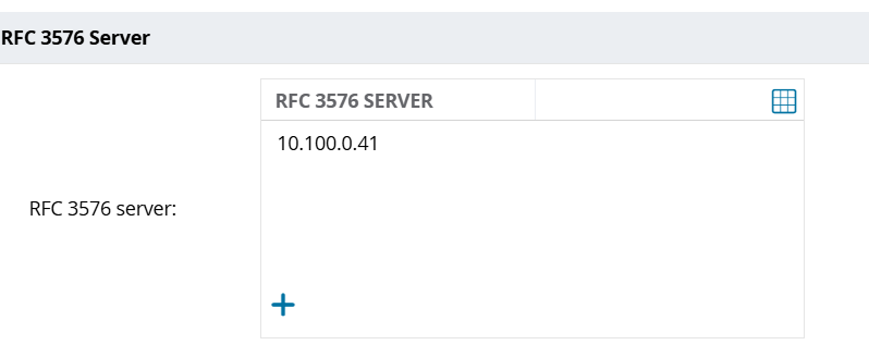

    Did you enable RFC 3576 in AAA profile and add RADIUS servers into profile server group?
    It's not obvious but by default DynAuth servers are not added to SSID profile when you create it.
    Best, Gorazd

    Hello Gorazd, thanks for your input. Yes, i have configured two radius servers as " rfc3576 servers" and assigned them to the SSID in the AAA profile. that looks good too.

    Posted 12 hours ago
