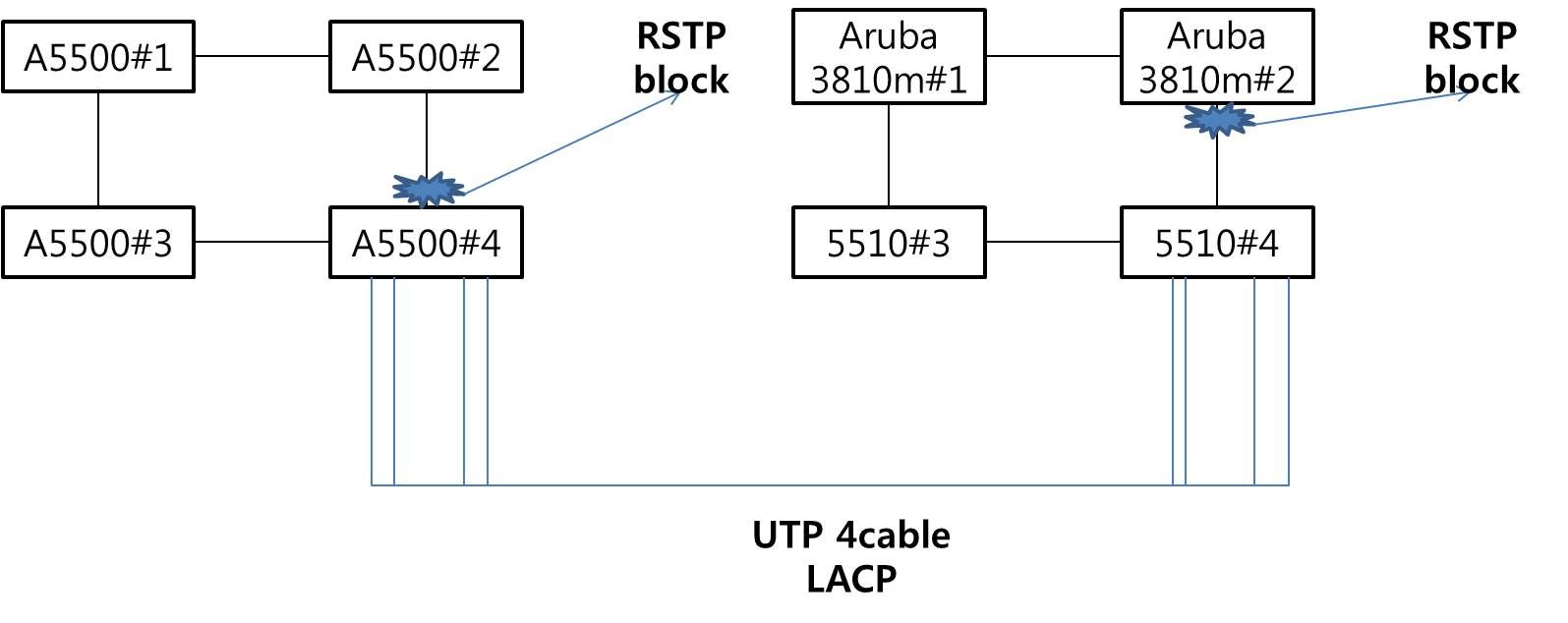

    A5500 (comware5)#4-5510 (comware7)#4 will be linked to UTP 4 cable lacp.
    The A5500 (comware5) is rstp and the 5510 (comware7) is pvst.
    Do you mind if I do trunk permit all?

    Both side bridge aggegation config should be same.
    If you are allowing all vlans then do it on both side.
