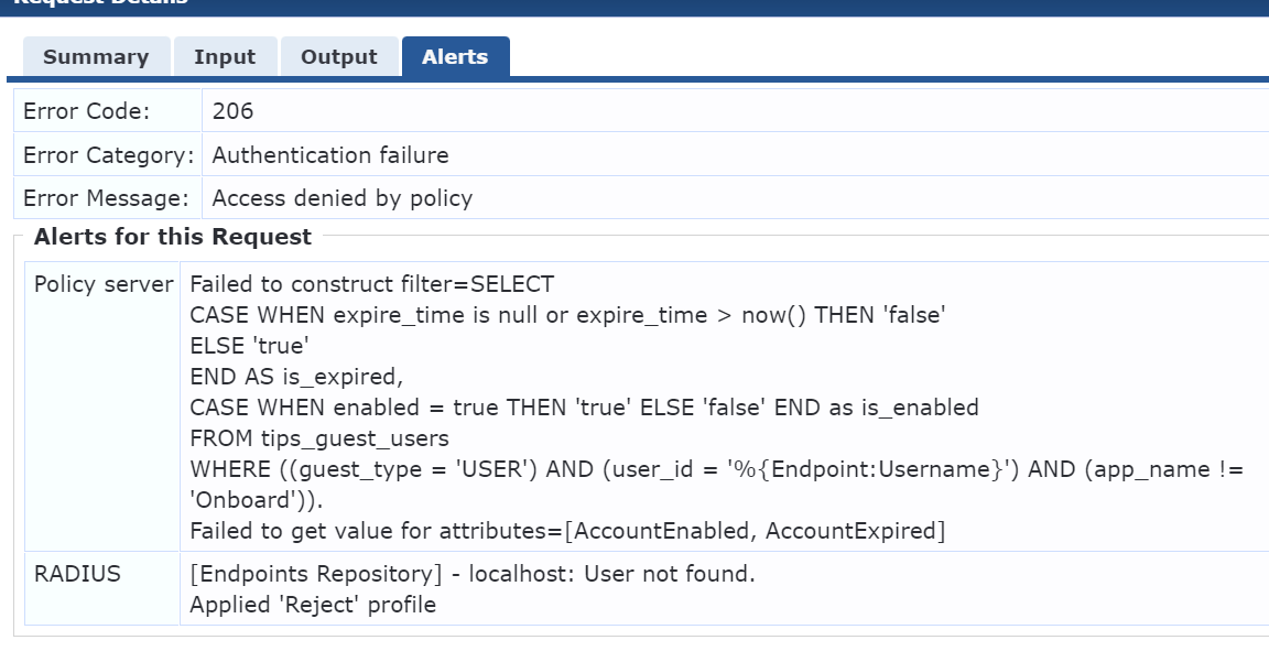

    Any ideas what i could missing? when i see the access tracker i get something like this
    Policy server Failed to construct filter=SELECT
    CASE WHEN expire_time is null or expire_time > now() THEN 'false'
    ELSE 'true'
    END AS is_expired,
    CASE WHEN enabled = true THEN 'true' ELSE 'false' END as is_enabled
    FROM tips_guest_users
    WHERE ((guest_type = 'USER') AND (user_id = '%{Endpoint:Username}') AND (app_name != 'Onboard')).
    Failed to get value for attributes=[AccountEnabled, AccountExpired]
    RADIUS [Endpoints Repository] - localhost: User not found.
    Applied 'Reject' profile
    It seems like tips roles its never equal to [Guest]  (i used the mac caching template to build it)
    But like i said i have a lab that works fine with instant and aruba os8 with the same rules on the clearpass but does not work with the aruba os10 on tunnel mode with aruba central and the gateway

    Does the request in ClearPass map to the correct (expected) service?
    Can you share the other output of Access Tracker?
    Can you share the configured service?
    Can you change the [MAC Auth] Authentication Method to [Allow All MAC Auth]?
    What other Authorization Sources have you added in addition to Endpoints Repository?
    The Policy server 'Failed to construct' messages (everything in the box) would be expected for an unknown client (no entry in the Endpoint Database yet) and if you include the Guest User Database as authorization source.
    There is quite some information to analyze, and I could imagine that you prefer to discuss the detailed configuration with your Aruba Partner or Aruba Support, but with the information above it may be possible to find out what needs to be done.

    1-Does the request in ClearPass map to the correct (expected) service
    I bealive so, its mapping the first one because its trying to mac authenticate
    2-Can you change the [MAC Auth] Authentication Method to [Allow All MAC Auth]?
    it was already on allow all mac auth
    I will show you what i see on the access tracker
    I will show you the config i have

    Ok, from this I can make up the following:
    - User connects to the network with a device that has not been authenticated as guest
    - The xxxx MAC Caching service matches [good]
    - As a result, there should be no MAC Caching for this device
    - Because none of the role mappings matched (no guest entries in the Endpoint), just the [User Authenticated] (default) and [Other] (default for the role mapping if none other matches) are assigned (see Access Tracker Summary tab)
    - That means no enforcement rule is triggered either, because both rules require at least one other role ([Guest]/[Contractor]/[Employee]); thus the default enforcement [Deny All] is returned, which means a Radius Accept-Reject.
    How equipment responds to that is different, and I think that is where the issue lies. AP with a Captive Portal profile will 'jump' in the redirect mode, but if you have a gateway that automatic role is probably not available on the gateway resulting in a default role or rejected traffic at the gateway.
    What may work is to create a manual gateway role (that does the redirect but excepts traffic to ClearPass) and return that instead of sending a Deny Access. Where I would create an enforcement rule at the bottom that does Role = [User Authenticated] -> Return Guest Captive Portal Role (which has the name of the gateway role that handles the captive portal). You could ask assistance from Aruba Support as it may be somewhat hard to do for the first time.
