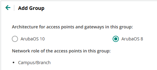

    I would create a new Group for AOS8 APs and configure everything like in the AOS10 Group. Additionally set the Firmware Compliance of that Group to the wanted InstantOS Version (depends on your AP Types) and test the whole configuration by moving one Test AP into that Group.
    When everything works fine you can move all the existing APs into the Group. After Firmware upgrade and Config sync the infrastructure should be ready. When Subscription ends everything runs in a local mode.

    yes if you want instant cluster, then downgrade to 8.x
