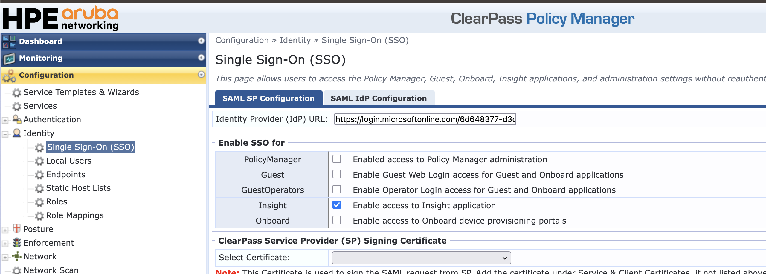

    After crashing my ClearPass on first try (SSO was not disabled properly after test and was applied to Policy Manager, recovery via SSH and "system sso-reset"...) I've finally managed to run SSO for Guest and Insight. This was really straightforward! With the SSO Service Template I got a simple Enforcement Profile with SSO-Role = Super Administrator. I would like to tweak SSO Service / Profile so that I can give different privileges to Admin, Support and Compliance similar to Active Directory authorization via group membership. Can I use AD or Entra for that?

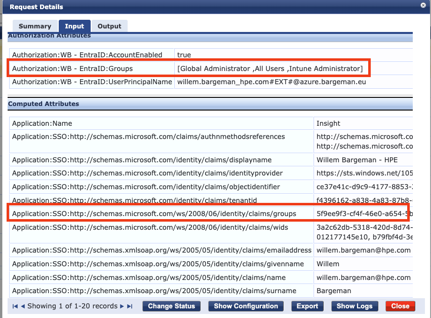

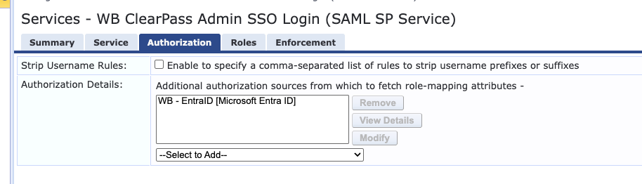

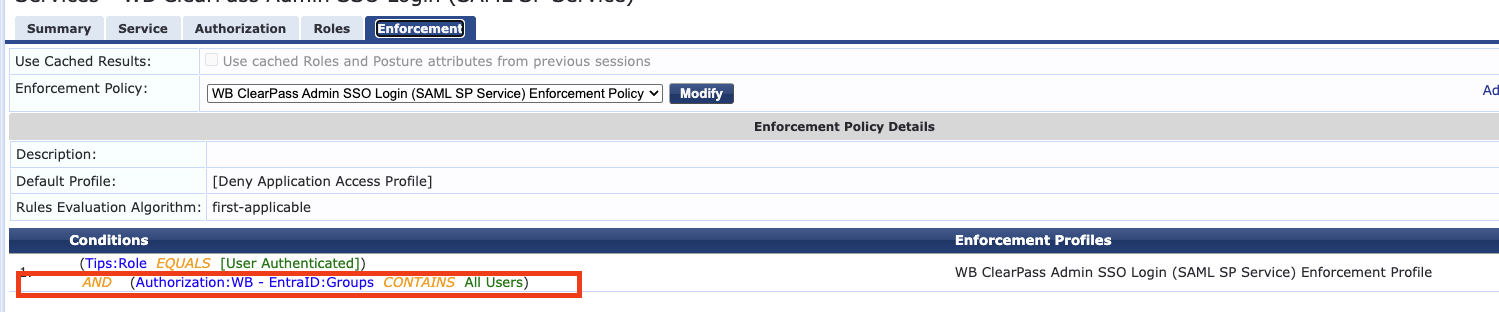

    Using AD or Entra for authorization is certainly possible. Just add Entra or AD as AuthZ source to the service and built the Role Mapping to assign the required permissions. The SAML username will be used to do the lookup in AD or Entra. Other option is use the SAML claims to assign the right level.

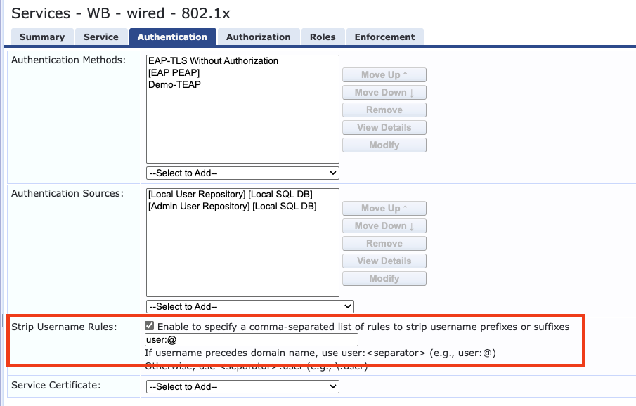

    The easiest one will be the EntraID AuthZ source or using the SAML claims. Please note that it is possible to strip domains from the usernames.
