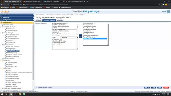

    on our clearpass, we would like to custom syslog message to SIEM syslog server like picture below

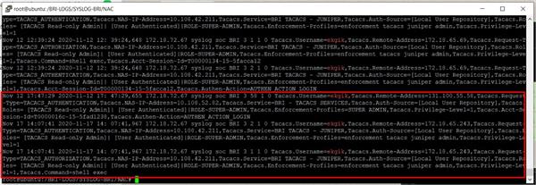

    and on our SIEM received syslog message like picture below,
    and the question is, can we custom syslog message that clearpass send to SIEM is logs of command CLI that user input on NAD ?

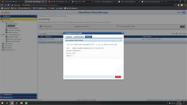

    just like log accounting on clearpass like below,

    I don't think you can send TACACS Accounting records out to syslog from ClearPass. What you probably can do is enable command accounting on your network devices (switches, APs, controllers, etc) and send that directly to your SIEM.
