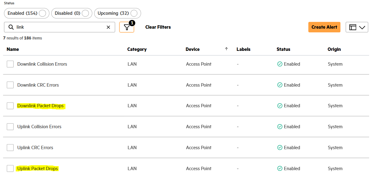

    the screenshot indicates that the alert is for downlink packet drop rather than uplink. there is a separate alert for uplink packet drops.
