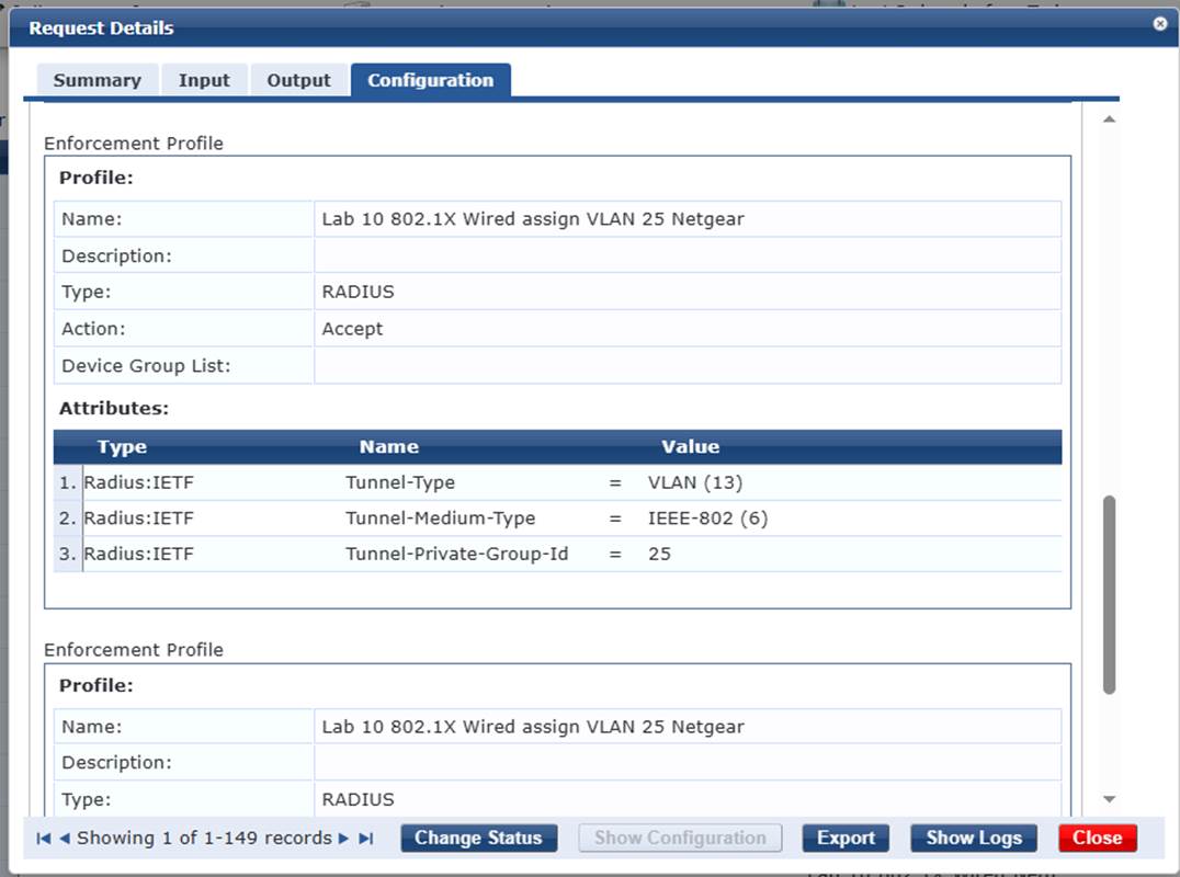

    In my journey to learn more of Clearpass, I decided to test the dynamic VLAN feature against a consumer-grade switch I have here at my home. I got as far as my service recognizing the policy and sending a RADIUS response. For some reason the switch won't recognize it responding with the following error:
    08 Mar 2025 17:54:04 UTC-5:00%SEC-W-SUPPLICANTUNAUTHORIZED: username kees with MAC e0:d5:5e:e2:92:7d was rejected on port g3 because Radius accept message does not contain VLAN ID
    08 Mar 2025 17:54:04 UTC-5:00%AAAEAP-W-RADIUSREPLY: Invalid attribute 65 ignored - tag should be 0
    08 Mar 2025 17:54:04 UTC-5:00%AAAEAP-W-RADIUSREPLY: Invalid attribute 64 ignored - tag should be 0

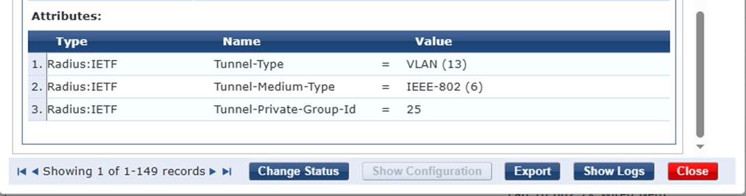

    Initially I used these attributes.
    Radius:IETF:Tunnel-Medium-Type (attribute 65)
    Radius:IETF:Tunnel-Private-Group-Id
    Radius:IETF:Tunnel-Type (attribute 64)
    When I adjusted the configuration only sending ":IETF:Tunnel-Private-Group-Id" based on the output that attribute 64 and 65 weren't recognized. I received this message below.
    08 Mar 2025 18:12:26 UTC-5:00%SEC-W-SUPPLICANTUNAUTHORIZED: username kees with MAC e0:d5:5e:e2:92:7d was rejected on port g3 because Radius accept message does not contain VLAN ID
    08 Mar 2025 18:12:26 UTC-5:00%AAAEAP-W-RADIUSREPLY: Invalid attribute 81 ignored - tag should be 0 or greater then 31

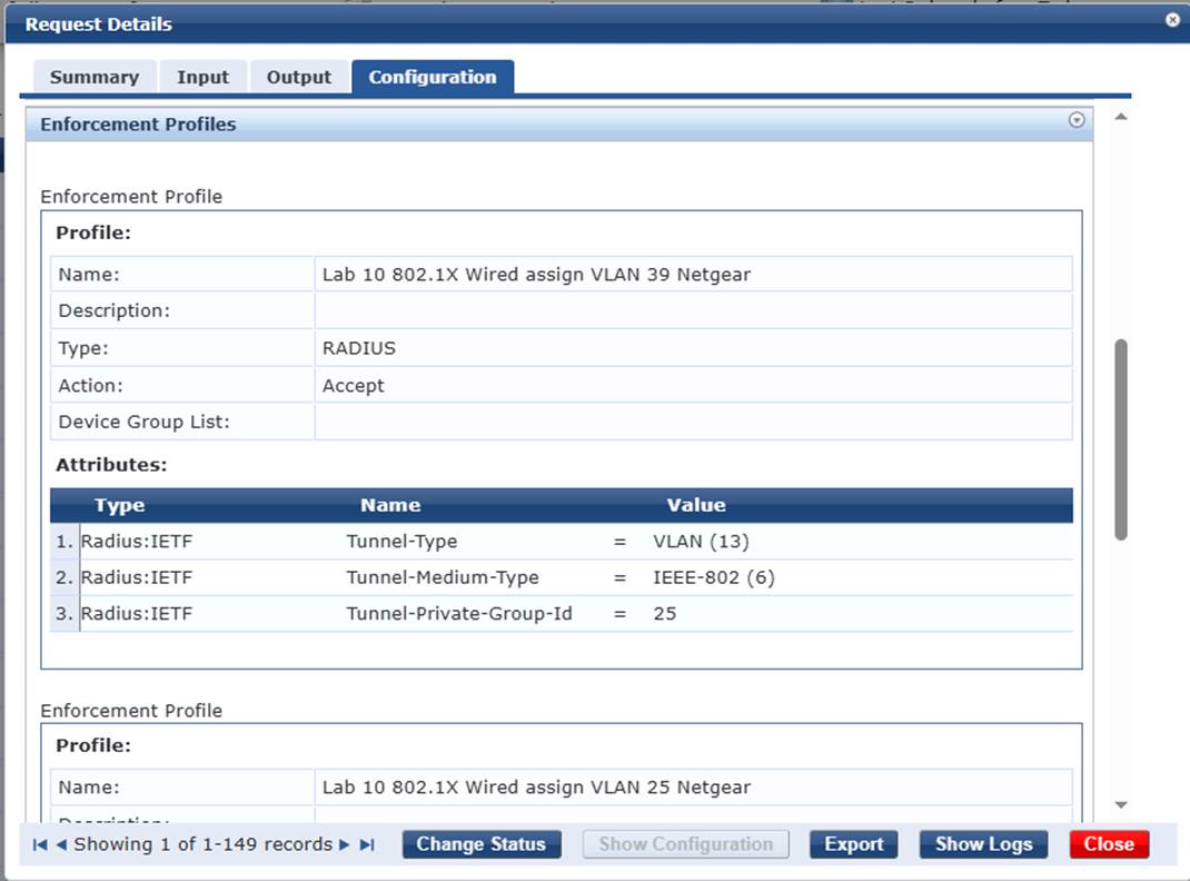

    Initially I had configured the RADIUS setting in Clearpass to use: IETF:Tunnel-Private-Group-Id: 25. I adjusted it later to 39 in anticipation to the message tag should be 0 or greater then 31 . But this did not work.
    Am I overlooking something? I am hoping from one hobbyist to another someone has encountered something similar in a home lab as well, or observe a mistake in my configuration below.
    In parallel I will reach out to Netgear to see if it can be solved through that way. If so, I will definitely share this information with the community!

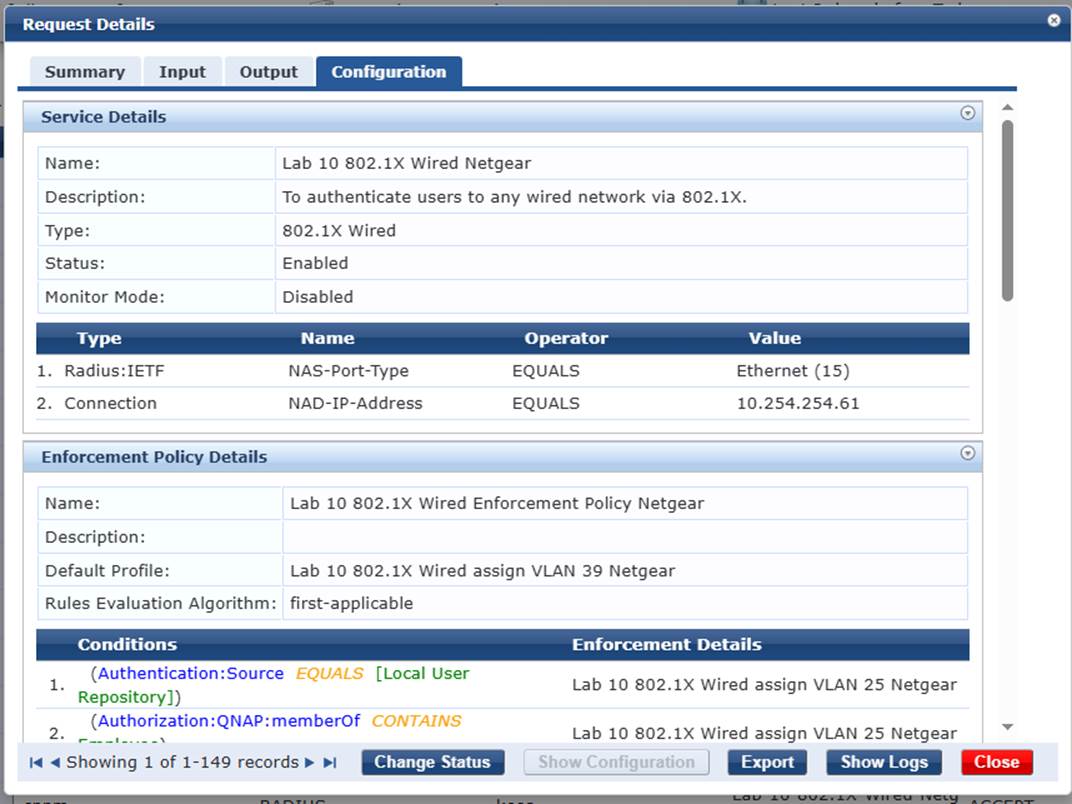

    NAD-IP-Address: 10.254.254.61 is netgear switch
    Here's some screenshots. Hope you can help me.

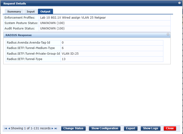

    Thanks, unfortunately, I am still fighting with this, I got a little further now. When adding the Avenda-Tag-Id I am no longer receiving error messages about attribute 64 and 65 which still are being send in the accept message (see below).
    However in each case I kept receiving the message: was rejected on port g3 because Radius accept message does not contain VLAN ID
    I started editing the XLM file which was a bit easier in this case and used the syntax below.
        <RadiusEnfProfile description="" name="Lab 10 802.1X Wired assign VLAN 25 Netgear" action="Accept">
          <AttributeList>
            <Attribute displayValue="25" value="VLAN ID:25" name="Tunnel-Private-Group-Id" type="Radius:IETF"/>
            <Attribute displayValue="IEEE-802 (6)" value="6" name="Tunnel-Medium-Type" type="Radius:IETF"/>
            <Attribute displayValue="VLAN" value="13" name="Tunnel-Type" type="Radius:IETF"/>
            <Attribute displayValue="0" value="0" name="Avenda-Tag-Id" type="Radius:Avenda"/>
          </AttributeList>
        </RadiusEnfProfile>
    I tried:
    • Changing the order of the attributes
    • Adding quotes to change is from integer to string
    • Using U:25 and U:Data instead of the VLAN ID
    • Nothing seems to work
    On a positive note , I learned that it can be easy to edit profiles using XML and that order of attributes can influence the outcome (however not in my case it seems), but I still cannot get it to work. ChatGPT suggests NETGEAR-AVPair however google says "NO", I cannot find any Netgear attributes.
    Wonder if this is the end or if there is something else I can tinker with :). Thanks so far for the responses

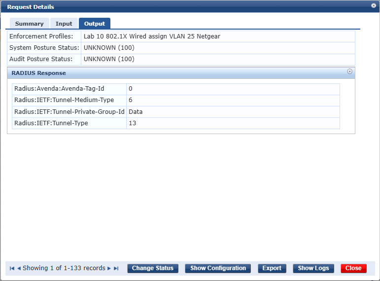

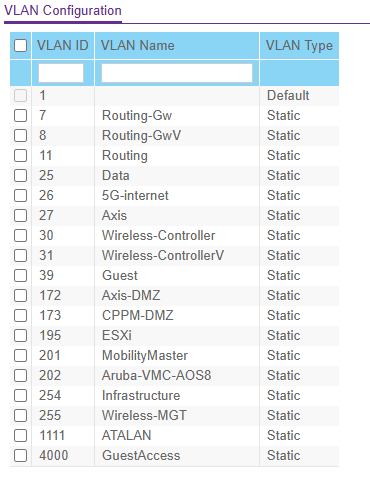

    Hurrah! Just as I was about to give up, I finally got it to work! As it turns out, with this $150 6-year-old switch instead of using the actual VLAN Tag I had to use just the VLAN name, nothing more.
    These are the attributes I send out:
    These are my VLANs

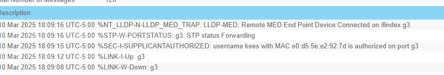

    This is my log message
    I will do a little bit more tinkering and create a small manual about this that I will post for another poor soul who uses these type of switches in their home/smb office.
    Final takeaway, it would have been great if the developers of this switch would have followed a descriptive logging message, referring to the VLAN ID instead of the VLAN Name would have saved me 4 hours of troubleshooting. I advise people to read this:  The 10 commandments of logging - Masterzen’s Blog
