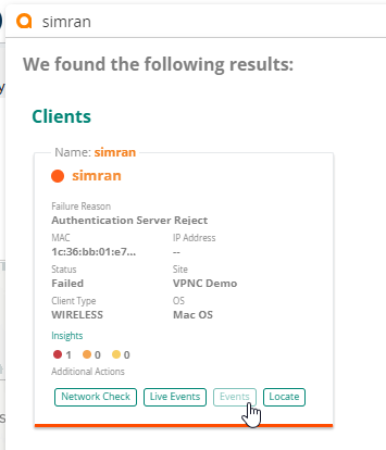

    The Client does not complete EAP communication and has EAP failures, so that the Radius Server rejected the Access.
    Seems that the client is not configured correct. Please check the Clients Supplicant config.
    Serach for the Client (MAC or Name) in the search field
    here you will be guided to the Cloients Detail Page
    Can you check for AI Insights data
    Also Events are important to give an idea of the issue
