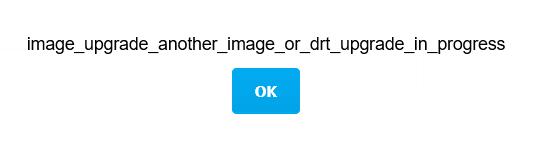

    I'm trying to upgrade a cluster of 60 AP model 207 from firmware 8.4.0 to 8.5 up to 8.7 with no success.
    The response is always the same from GUI and from CLI:
    The other image/drt Upgrade or image sync is in process
    I tried to reboot the cluster try auto update different manual image upload but with no success
    Any ideas?

    # reset drt

    No Airwave or Central included. The cluster reboot didn't solve the issue.
    In fact we were trying to add some APs model 303 on the same cluster and they fail to join in.
    We tried to upgrade the existing cluster of 207 to match the FW of the newly added 303 and fail to do so.
    When we moved the 303 on a different VLAN the upgrade of 207 went ok. Maybe being on the same vlan with this APs (303 not joined in the cluster) still blocked the upgrade process of the existing cluster of 207.
    Now they are on FW 8.5 and on same cluster.
    Regards
