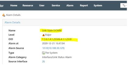

  • 4.  RE: IMC email alerting
    Posted Mar 21, 2021 11:53 PM
    Hi @prodigy811
    If you navigate to Alarm >> Alarm Browse and select any Link UP or Down event, you should be able to find the OID
