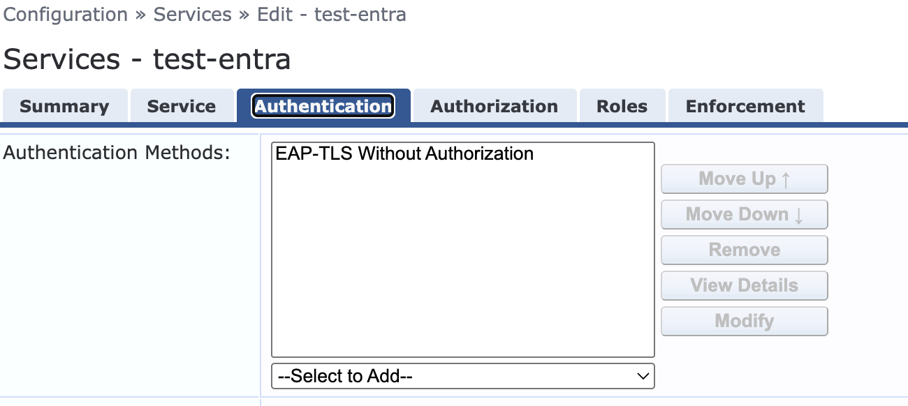

    I also switched over to HTTP lookup, and that is now working, however I came across something not mentioned anywhere that I could find - although HTTP lookup is only authorization, Clearpass would not let me create a Service without at least one Authentication Source with an error: Authentication Sources are not configured
    I added the default [Endpoints Repository] [Local SQL DB] but this still meant that completely new devices to Clearpass would initially fail and not be looked up for Authorization attributes. I realize this is a bit of a corner case because if the device exists in Intune it should be populated to the Endpoints database, but in my case when troubleshooting I wanted to delete the endpoint and test as if it was a very new unknown device.
    The fix for this was to create a new role for unknown entra devices with an Enforcement Profile that sets the Endpoint to Known state. Then on the next attempt it would be queried against the HTTP method to Intune and pulled down all the attributes against it's Intune ID in the SAN URI. This worked well and populated the Endpoints database with two different entries - one for the most recent wired MAC-address in Entra, and the other the Wi-Fi MAC-address used for the auth attempt.

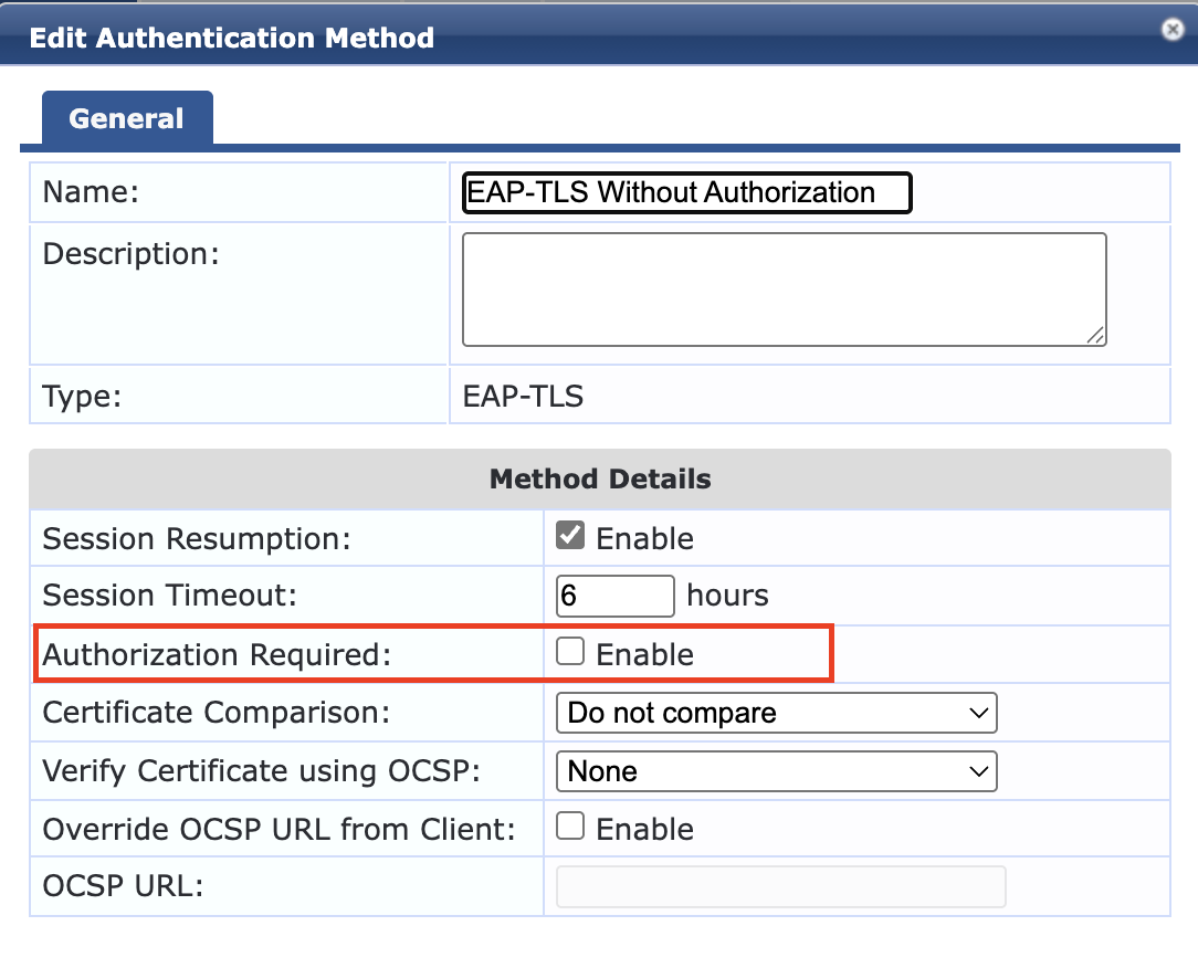

    Regarding the auth source that is required. That is not completely true. The auth source is optional when you the auth method is TLS without authorization enabled.
    For each authentication request ClearPass will do a lookup in Entra. It depends on your role mapping / enforcement policy if the device is allowed for the first time.

    Authorization disabled means that the user/device doesn't need to exists in the authentication source. And for Intune devices this is the case. The endpoint DB doesn't need to be used for authentication. For Intune devices the following is recommended.
    • EAP-TLS or EAP-TTLS authentication.
    • During authentication the certificate is verified. The CA's in the Trust List are allowed. If you want to filter the allowed certs for that specific service, you can use the role mapping policies
    • After authentication the authorization process starts. During this stage information is fetched from sources like Intune / Entra and maybe the EndpointDB. This stage is important to assign the right privilege level
    Disabled Authorization in the Auth Method doesn't mean there is no Authorization done. It simple means that the user/device doesn't need to exists in the auth source
