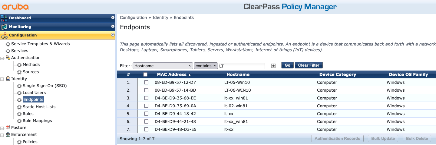

    Endpoints Database is where all of the MAC address seen by ClearPass are stored:

    as mentioned earlier, the endpoint db will have all the mac address and profiling information for any device that does MAC auth. You can also add manual attributes to it or use enforcement profiles to update an attribute based on your policy.
    to make use of any Endpoint attributes, you need to check for it in role-mapping or in your enforcement policy.
    https://www.arubanetworks.com/techdocs/ClearPass/6.11/PolicyManager/Content/CPPM_UserGuide/Admin/EndpointsHelp.html
    Now for MAC auth, when you configure the service, by default, endpoint db is used as Auth source, it will look for endpoint attribute "status", if it is known, it will pass the mac-auth. if status=unknown then you can use that and redirect to a captive portal (as an example)
    you dont need to reorder anything in endpoint db, but if you want to use it for mac-auth service, then you need to add it as an auth source, then you can make use of any of its attributes in your enforcement policy and role mapping logic.
