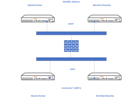

    Hello
    Firstly, forget to say : ArubaOS 8.6.0.15
    I've
    2 MDs, Conductor + Member
    2 MM's Master + Member
    Between is a Firewall

    Mobility Master = Mobility Conductor. The nomenclature changed time before. Hence, do you refer that have 2 MMs (Master or conductor) and 2 MDs (controllers) ?
    If the answer is yes. The configuration occurs from MM to MDs and you need configure data syncronization between MMs as Joseph told you.
