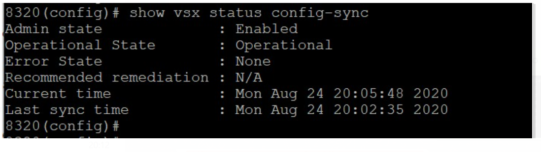

    Show vsx status config-sync

    Where is the LAG 200 (as per your screenshot)?

    SW-8320-SEC# show lacp interface multi-chassis
    State abbreviations :
    A - Active P - Passive F - Aggregable I - Individual
    S - Short-timeout L - Long-timeout N - InSync O - OutofSync
    C - Collecting D - Distributing
    X - State m/c expired E - Default neighbor state
    Actor details of all interfaces:
    Intf Aggregate Port Port State System-ID System Aggr
    name id Priority Priority Key
    1/1/47 lag200(mc) 1047 1 ALFOE 02:01:00:00:01:00 65534 200
    Partner details of all interfaces:
    Intf Aggregate Partner Port State System-ID System Aggr
    name Port-id Priority Priority Key
    1/1/47 lag200(mc) 0 65534 PLFOEX 00:00:00:00:00:00 65534 0
    Remote Actor details of all interfaces:
    1/1/47 lag200(mc) 47 1 ALFNCD 02:01:00:00:01:00 65534 200
    Remote Partner details of all interfaces:
    1/1/47 lag200(mc) 80 1 ALFNCD b8:d4:e7:0b:32:c0 65534 200
    SW-8320-PRI# show lacp interface multi-chassis
    1/1/47 lag200(mc) 0 65534 PLFOXE 00:00:00:00:00:00 65534 0
