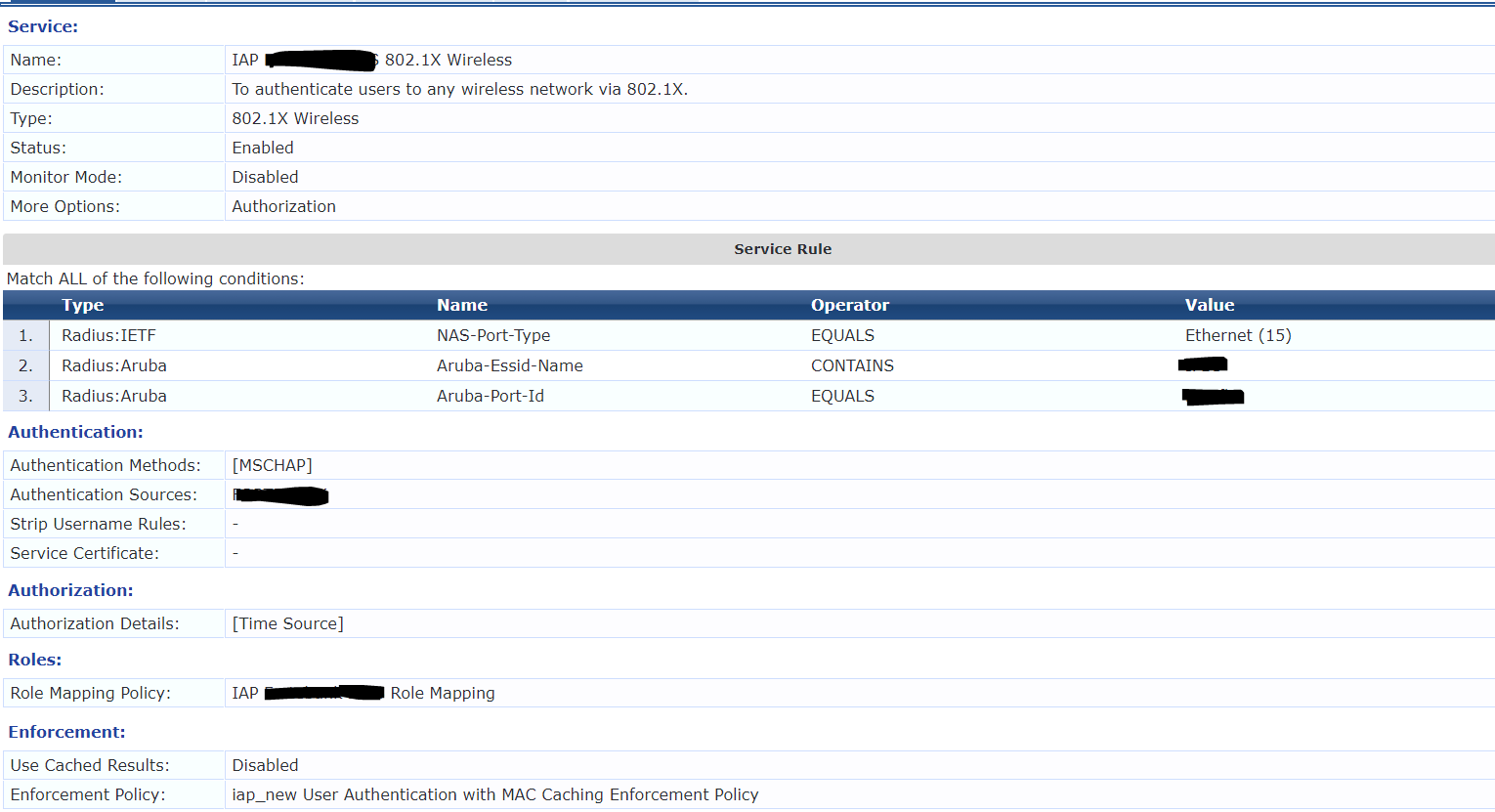

I have tried this before, but got an error as follows.
In log file I see this error
ERROR RadiusServer.Radius - rlm_auth_check: Auth-Type not set or authentication methods have not been configured. Rejecting it.
This is the authentication method. And it works for other services used in ClearPass and for the previous configuration with other Vendor settings everything was fine.

For now I've double checked my ClearPass services and role name on both ClearPass and IAP.
May be the selected services are wrong, but according to Access Tracker they have choosen corretly by the type of request.
Here some screenshots. Some sensitive information was hidden. But the role name is exatly the same everywhere.
1 service for Raduis request
2 service for Webauth
Here is my web login page
And logs from the Access Tracker
