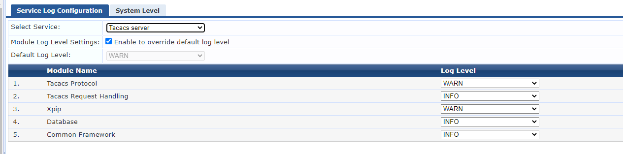

To identify the issue, you need to have "Tacacs server" service in DEBUG. Navigate to Administartion->Server Manager->Log Configuration. From the drop down, select the service as Tacacs server and place the default log level to "DEBUG" and save the config.

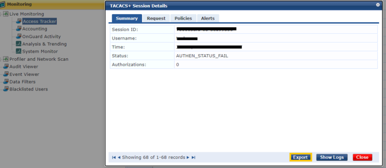

Replicate the issue by connecting to NAD and export the access tracker log (Monitoring->Access Tracker). Click on the request and click "Export" or you can click on "Show Logs" to view the logs
After the access tracker log is exported, navigate to Administration->Server Manager->Log Configuration. From the drop down, select the service as Tacacs server and place the default log level as shown below and save the config:

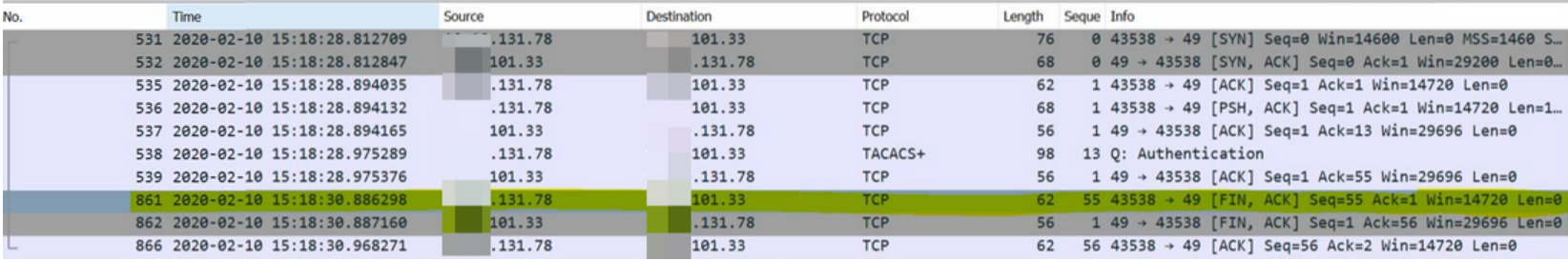

From pcap, we can see that session was closed by NAD IP:x.x.131.78 at 15:18:30 (frame no:861)
From pcap, we can see that Clearpass received the response from token server(x.x.24.12) at 15:18:32 (which is seen in tacacs log as highlighted above as well). As the session was closed by NAD device:x.x.131.78 by 15:18:30, in access tracker we see the error: Connection closed by remote end.
