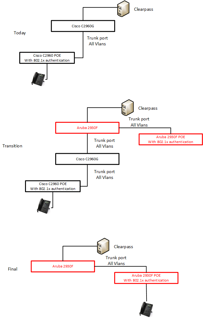

    Maybe you can post a drawing/diagram of what you want to do and where 802.1X is configured.

    A diagram of what I want to do :
    The issue is during the transition phase : 802.1x authentication is NOK. On the Clearpass, we don't have any Cisco IP phone authentication request.
    During the previous phase and the final one, 802.1x authentication is OK. Cisco IP phone requests join the Clearpass.
    I hope it's more clear.
    I don't know why 802.1x authentication requests are not relayed by the Aruba 2930F and, for the moment, the solution for me is to pass very quickly to the final phase.

    That diagram makes it more clear, and sounds like a proper migration scenario.
    In the transition mode, the 2930F that is sitting between the ClearPass and the 2960G should not do anything with the 802.1X, similar the 2960G should not do anything with 802.1X; just the 2960 PoE and the 2930F PoE. For the intermediate switches, that is just RADIUS traffic, and if you don't see the request coming in, make sure that on all hops (2960 PoE, 2960G, 2930F) all the relevant VLANs are passed through on the trunks. I expect the VLAN carrying the RADIUS traffic being missed, or an issue with the L3 if there is VLAN routing, or an ACL on one of the switches may be the issue.
    I would hop by hop do some port mirroring to see where the RADIUS packets go lost. Shouldn't be too hard to find.
