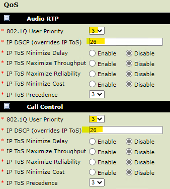

    The intent is to have the switch assign a DSCP to all traffic on VLAN 10, overwriting the DSCP value from the VVX311 config. For testing I set the VVX311 to a DSCP value of 26 (AF31) and a 802.1Q value of 3.

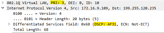

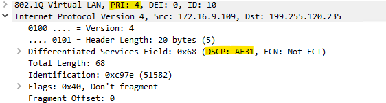

    With the configuration I would expect all traffic leaving port B19 on the switch to have a DSCP value of 46 and 802.1Q priority set to 5. When I do a packet capture on eth4 on the firewall however, the DSCP value is unchanged from what is set on the phone. Also, the 802.1Q PRI value is changed to 4.
    For comparison here's a capture directly from the phone eth0 interface before the packet gets to the switch:
    As you can see the DSCP is not changed by the switch but the PRI field is. According the Advanced Traffic Management Guide for this switch, the DSCP value should be overwritten.

    It was my misunderstanding of the type-of-service classifier. Having type-of-service enabled and set to Differentiated Services causes the switch to remark packets based on the following table

    And since the type-of-service classifier has a higher precedence than vlan-priority, the vlan-priority was being ignored. The resolution was to disable type-of-service.
