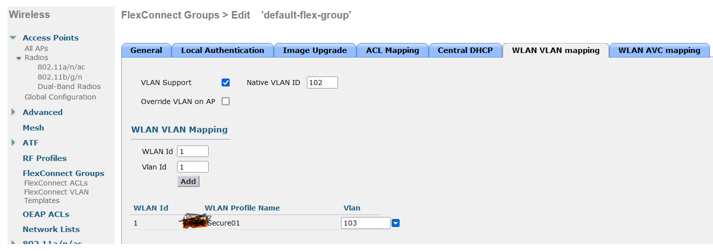

    I know is an old thread but the way to make it work, like you said is config vlan mapping in the flexconnect group
    In my setup the vlan 102 is used for the APs and 103 is used for the clients. The switch port has the 102 as native/untagged and the 103 as tagged/trunked
    Hope this helps, it took me a little while to find the solution and how to do it since I don't manage Cisco's wlc
