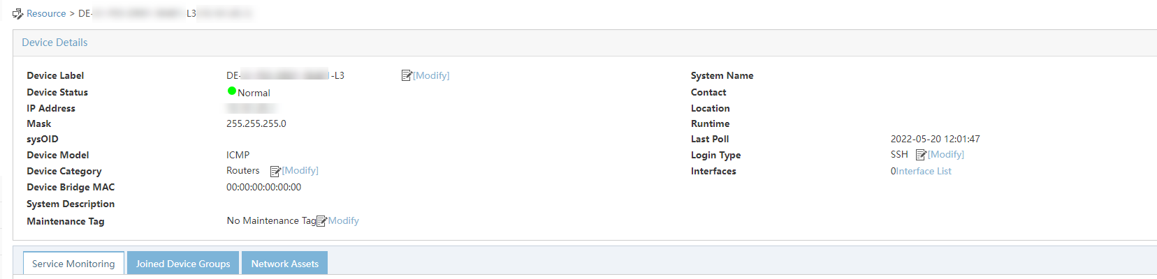

    I have the problem that a device is always shown to me as ICMP.
    This is a HP J9850A Switch 5406Rzl2.

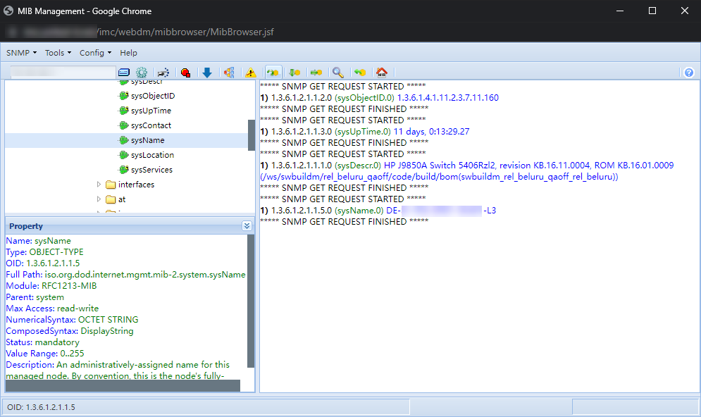

    I tried to connect the switch to IMC again but the result is the same.
    SNMP V2 is disabled and we only use SNMP V3. The connection also works from the IMC server (Windows) and via the MIB browser in IMC itself.
    We also query the switch in another monitoring tool which works without problems.
    Since this is not the only type of switch, I don't know what to do because all the others have the same firmware: KB.16.11.0004.

    The device is connected without an error message.
    I can also find the device but the information that should come from the device is not present.
    On the server where IMC is running I can query data as well as via IMC itself.
     We have several of these switches and types in use without problems only this one makes problems.
