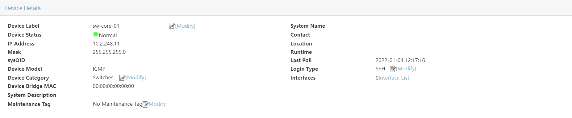

Hi,
What firmware version ?
Do you have enable SNMP ?

Hi,
i just set up HPE IMC (iMC PLAT 7.3 (E0706P06) and did an auto discovery.
Our 2930F Switches get acknwoledged just fine but our 8320 Switches get Device Category "PC" and i cant see any Information about them, no Interfaces, Systems name etc.
Do i need to configure something extra in IMC or on the Switch? I cant find any Information in the forums or Interweb.
Login is via SSH and the SSH testin IMC is positive.
thanks in Advance,
Harald
