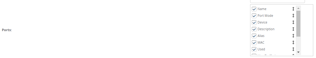

    Right now I don't believe this is possible. The reporting can include the following in the image below, along with traffic usage (not pictured because it was cut off). You can see the VLANs assigned on the device page however, jut no reporting on it :(
