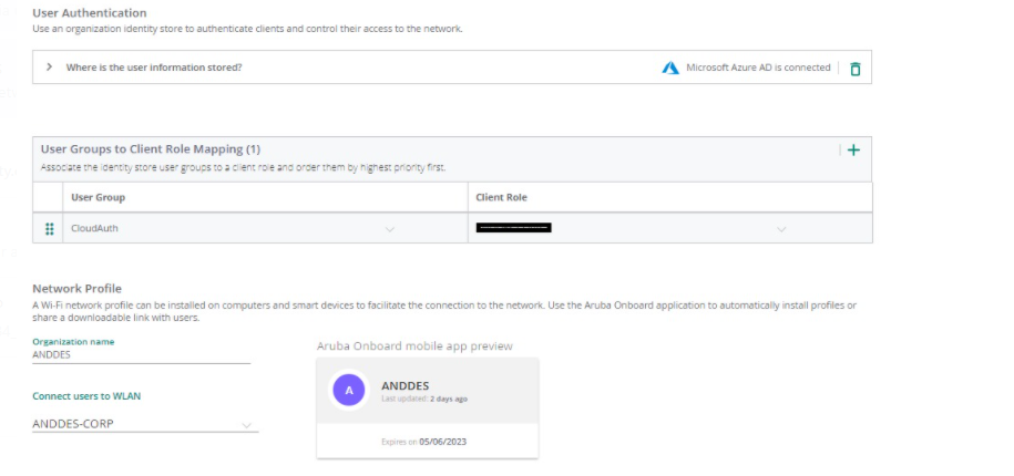

    Dear Community.
    I have the following case with the central Aruba cloudauth integrated with the Active Directory in Azure.
    In the authentication and access process, the rad-recj, eap-failure, and server failure messages are observed.

    In the configuration process, the guides and recommendations were followed step by step, not encountering problems, and observing the correct one.
    operation in central Aruba with AD connection.
    The problem occurs with users who try to access the wireless network, through the cloudauth method.
    Please help me this case.

    What is most likely is that your user is not in the right Azure AD group that you selected. You could check the authentication logs (Global View, Security, Authentication and Policy, List view) and check the authentication log there for a reason that the authentication was rejected.

    For the connection of the final client with the Azure cloud, it is necessary to use the Aruba Onboard Application for the connection with a certificate.
    Below is the link:
    https://www.arubanetworks.com/techdocs/central/latest/content/nms/policy/prov-mobile-app.htm
