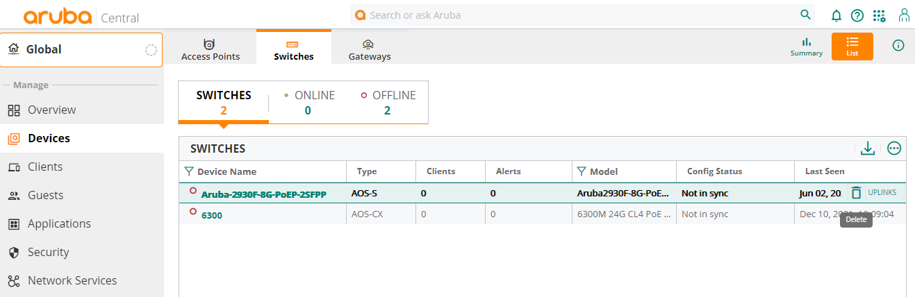

    Hello,
    I'm looking for a way to remove offline devices from the global view
    there are a number of devices that offline and will remain so for the next month or so, there are a number of sites that show on the map as red as a result of the know issues. I would like to exclude these as they are masking potential other issues
    is there a way to do it
    Brian
    Brian Connery
  • 2.  RE: Remove offline devices from global view?
    MVP GURU
    Posted Mar 04, 2022 02:20 PM
    If you hover over the device in the device tab you should be able to delete it. This will however remove it from the group it is in, but not from your device inventory. I believe this is the only way for it to not show up in the global view....
