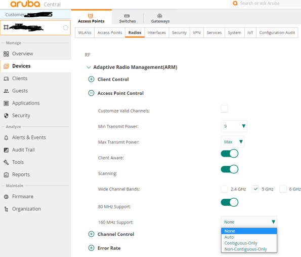

    It's seem like software on IAP still doesn't support 160Mhz yet, but i have tried with controller mode It's can working on 160Mhz, If you have a controller just go to looking rf profile.

    It is dependent on your regulatory domain:
    (Aruba7640-US) #show ap allowed-channels country-code US ap-type AP-315
    Allowed Channels for AP Type AP-315 Country Code "US" Country "United States"
    PHY Type                  Allowed Channels
    802.11g (indoor)          1 2 3 4 5 6 7 8 9 10 11
    802.11a (indoor)          36 40 44 48 52 56 60 64 100 104 108 112 116 120 124 128 132 136 140 144 149 153 157 161 165
    802.11g (outdoor)         1 2 3 4 5 6 7 8 9 10 11
    802.11a (outdoor)         36 40 44 48 52 56 60 64 100 104 108 112 116 120 124 128 132 136 140 144 149 153 157 161 165
    802.11g 40MHz (indoor)    1-5 2-6 3-7 4-8 5-9 6-10 7-11
    802.11a 40MHz (indoor)    36-40 44-48 52-56 60-64 100-104 108-112 116-120 124-128 132-136 140-144 149-153 157-161
    802.11g 40MHz (outdoor)   1-5 2-6 3-7 4-8 5-9 6-10 7-11
    802.11a 40MHz (outdoor)   36-40 44-48 52-56 60-64 100-104 108-112 116-120 124-128 132-136 140-144 149-153 157-161
    802.11a 80MHz (indoor)    36-48 52-64 100-112 116-128 132-144 149-161
    802.11a 80MHz (outdoor)   36-48 52-64 100-112 116-128 132-144 149-161
    802.11a 160MHz (indoor)   36-64 100-128
    802.11a 160MHz (outdoor)  36-64 100-128
    802.11a (DFS)             52 56 60 64 100 104 108 112 116 120 124 128 132 136 140 144
