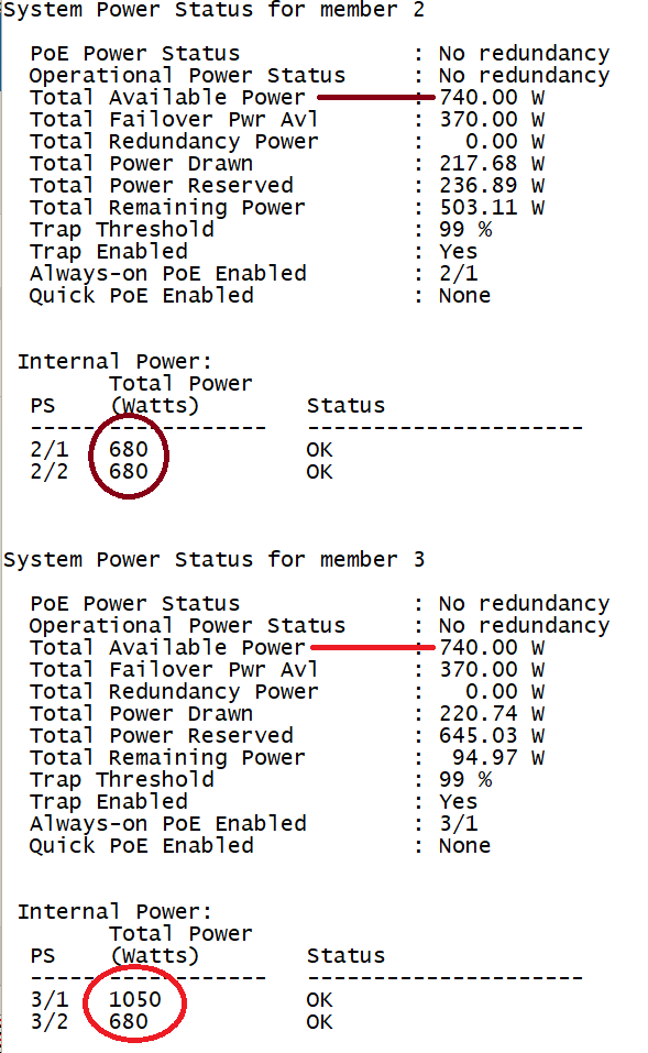

    How come is the "Total Available Power" the same in both switches?

    I believe it has to do with the following note in the documentation.
    Combining
    different PSU models in the same modular switch chassis is not supported and reduces PoE capacity.
    See POE planning and implementation guide for CX on https:/asp.arubanetworks.com.

    Yes, 6300M PoE Switches support 3 different PSU. Total power depends on PSU and connected to 110VAC or 220VAC.
