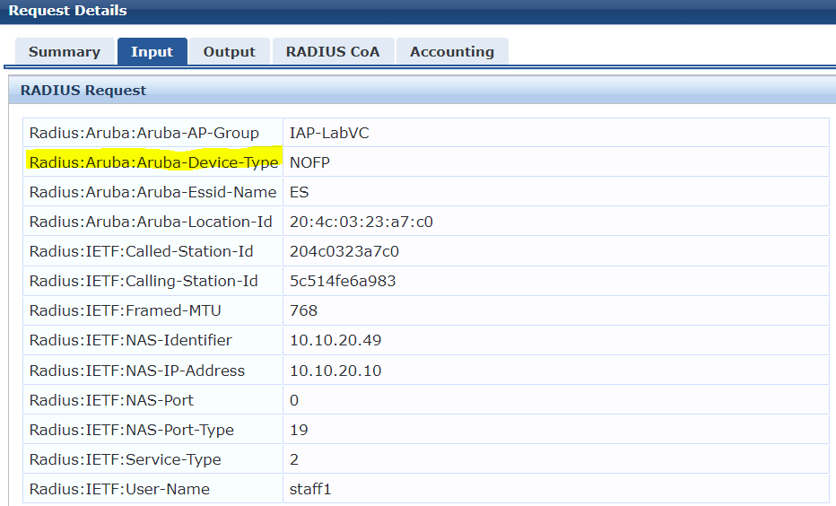

    ok thanks for clarification. Aruba-Device-Type is a RADIUS VSA that identifies a client based on its Operating System.
    Aruba controllers and IAPs send Aruba-Device-Type radius attrib automatically, you don't need to configure it.
    so you should see it for all the RADIUS requests coming from them.
    Here is the screenshot of access tracker from ClearPass that shows a basic dot1x request coming from an IAP.

    Thank you so much. So I am guessing the RADIUS Server fails to catch this information somehow.
