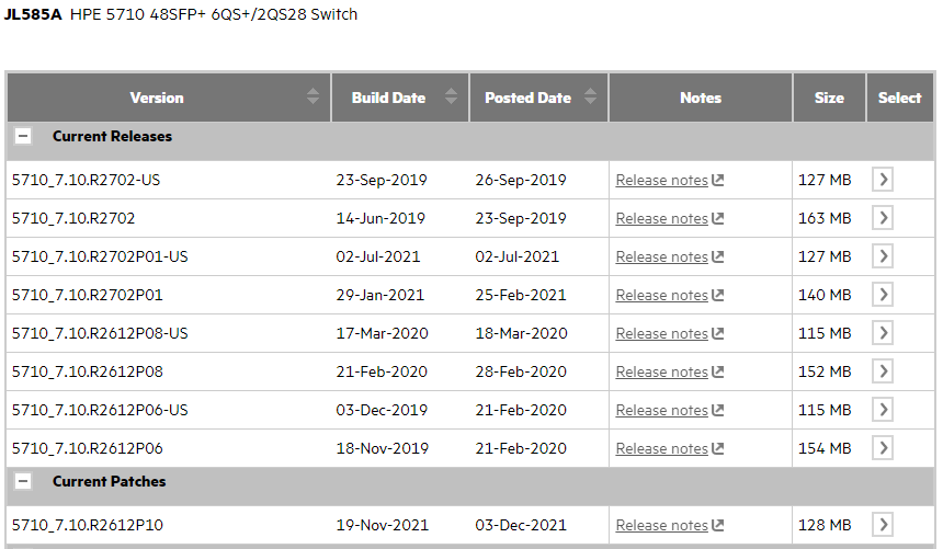

    I was not able to find the mentioned Hot Fix (R2702P01H03) valid for R2702P01, indeed the latest software build I was able to find (on ASP) is the R2702P01 that you already used, released on February 2021...and during July 2021 was just released the R2702P01-US software version.
    The same is true for the other mentioned Hot Fix (R2702H19) valid for R2702 software version.
    The above is confirmed by the table below:

    I was confused by your link too, I cannot found patch which is mentoined for my version. But, this is because this article is not from 2021, but from Apr.2022. So patch will release in next month :). (img bellow)

    Yeah, I was unsure too...I simply didn't take time to check in deep about the dates to understand that they were implicitly referring to July 2022 and not July 2021! Hey at HPE someone should take care about accuracy when writing such notes.
