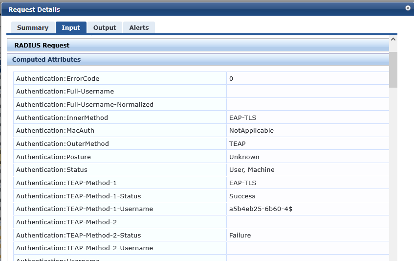

    @Herman Robers - doesn't seem to like EAP-TEAP as machine auth only (method-1), still getting the 404 error with no authorisation attributes even though the DeviceId is listed in the access tracker information.
    EAP-TEAP access tracker information:
    Works fine if connection is EAP-TLS only with the same authorisation source.
    Is this expected?
