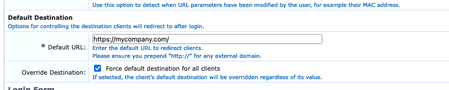

    Did you fill the redirect URL? That can be done either in the external captive portal profile in Central:
    .. (scroll down in that window with a scroll-wheel or double-finger gesture)... or in ClearPass under the default destination of your web login or self-registration configuration:

    Yes I did. I already fill the redirect URL both ClearPass and Aruba Central. do I need to upload a certificate since I'm using the aruba_default certifate of aruba central.
