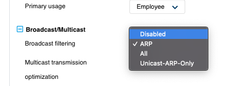

    Many of these devices might use broadcast technology to 'find eachother'. By default, Instant AP will block broadcast to increase performance, but that breaks these types of broadcast/multicast solutions unless you enable and properly configure Airgroup.
    You could try to see if that is the issue by disabling Broadcast filter under 'step 1' of the SSID configuration and then under Advanced settings:
    Set to disabled to allow broadcast/multicast.

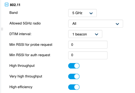

    You may also 'play' with HT/VHT/HE:
    High Throughput = 802.11n (should be good even for most IoT devices)
    Very High Throughput = 802.11ac (will probably not be supported by IoT devices anyway)
    High efficiency = 802.11ax (unlikely to be supported by IoT devices)
    Most clients will be happy to connect to an SSID with all 3 enabled, but there may be some exceptions.

    I disabled BroadCast Filtering already earlier.
    the 3 Option is also tried, but with no change.
