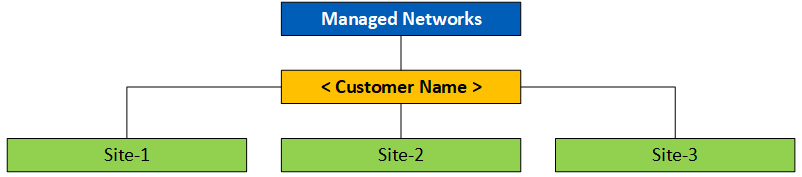

    We have a new project with an Mobility Conductor / Controller architecture. We have three sites with two controllers on each of them. I wondering what is the best design to ensure that the AP of Site-1 connect on Site-1 and failover on Site-2 or Site-3 in case of failure. The configurations will be the same on the three sites.
    I thinking about a cluster per site, and a failover between two cluster with the backup LMS configuration on the AP-Group but this only permit N + 1 failover and not failover between all clusters :
    There is other option to permit Failover like this ?
    In terms on configurations on the Mobility Conductor, to keep the same configuration between the three sites, I planned to use Managed Networks folder like this.
    Do you have any feedback about design like this ?

    My advice would be to have the AP System Profile point to the VIP for Cluster 1 be LMS, and the VIP for Cluster 2 be the B-LMS. If all 4 controllers are unreachable/down, I would then rely on the DHCP Options or DNS of aruba-master and in newer versions aruba-conductor for controller discovery upon boot. There is no tertiary setting for LMS.
