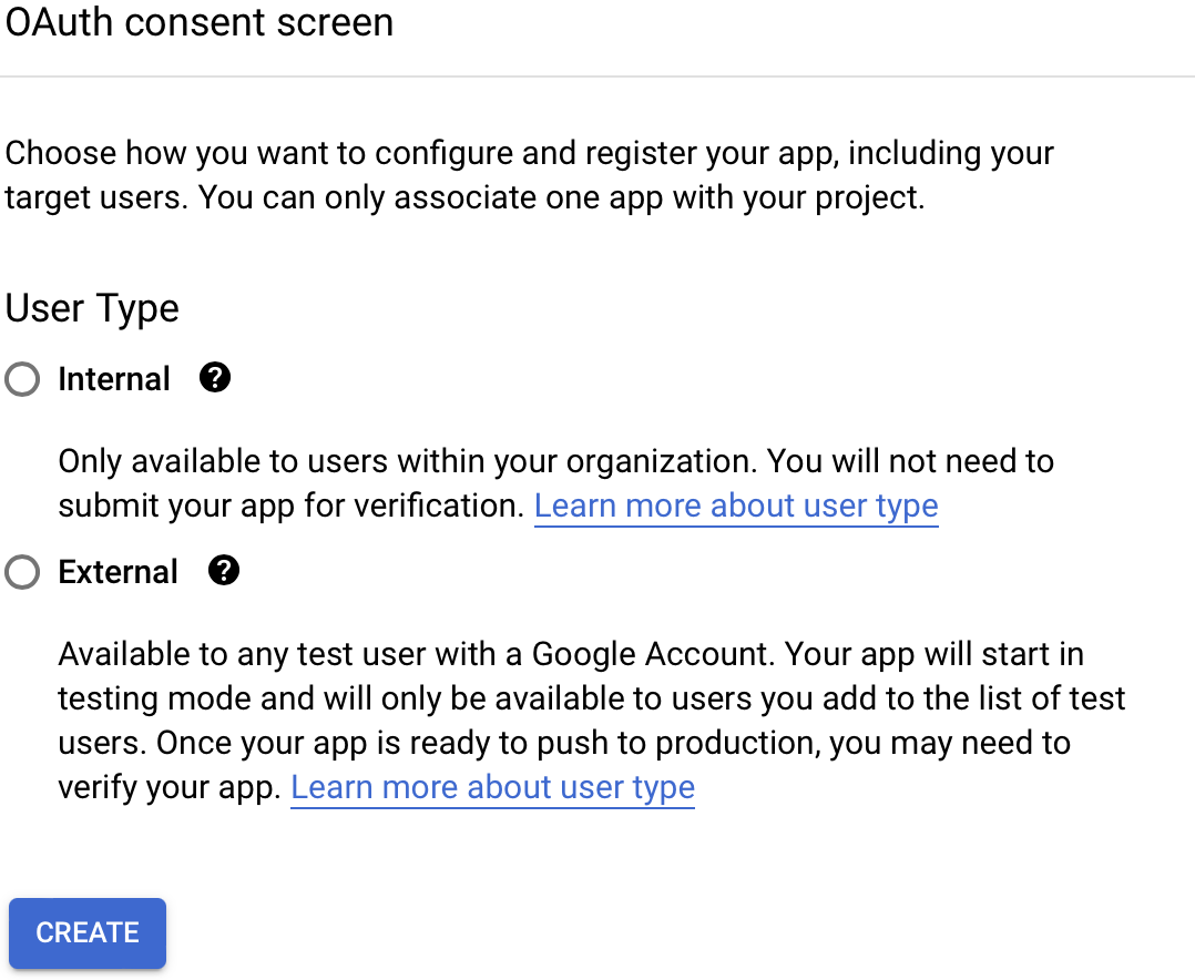

    Firstly when creating OAuth2.0 crediantials, G Suite asks to configure OAuth consent:

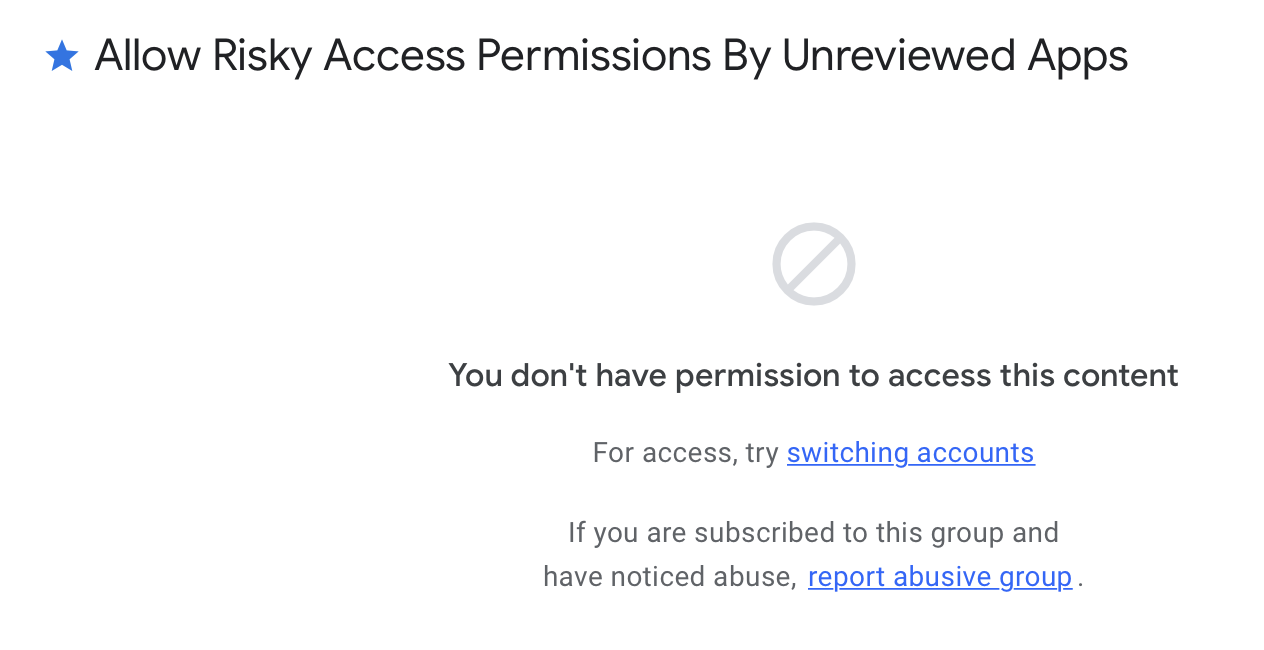

    Secondly, when trying to login with G Suite admin credentials to https://groups.google.com/forum/#!forum/risky- access-by-unreviewed-apps to allow custom OAuth web apps, it seems that admin don't have enough permissions:

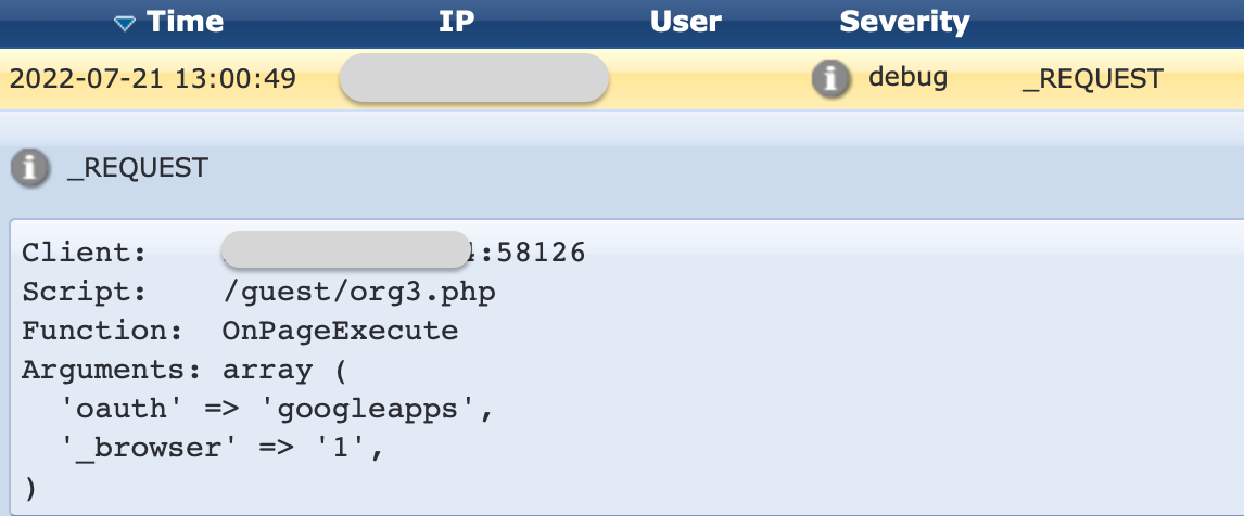

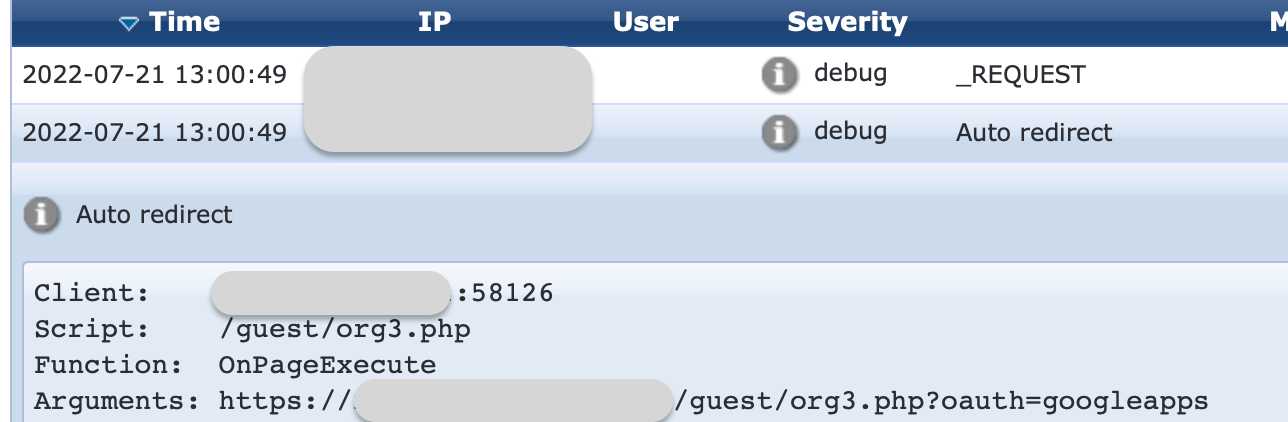

    In Applications logs we see an 'Auto redirect' and '_REQUESTS' logs:

    For the consent, you probably should pick internal. From the description, I make up that internal is used to authenticate users that are in your G-Suite. External can authenticate any Google Account and requires approval/additional configuration at some point in time. I assume you only need to Onboard users in your own identity store.
    The risky applications screen seems to be related to your admin account level. If there is a higher level admin account, you could try that. For example the account that was used to create the organization or the first admin created (apologies, I don't have access to G-Suite so just making interpretations).
    The Required Field missing message is in many cases related to a missing client MAC address, which is required for Onboard (and most Guest workflows) to operate. The MAC address is mostly added by the redirect, and makes opening the Webauth page from the ClearPass backend fail. You could try if it works when you add ?mac=00:00:00:00:00:00 to the end of the URL of the guest/onboard page, or if there is already a ? in the URL, add &mac=00:00:00:00:00:00 to the end to see if the 'required field missing' disappears.
    What also may help is using the developer tools in your browser (Ctrl-Shift-I / CMD-Shift-I on mac) to trace the request and redirects.

    You are right, at the moment I'm doing Onboard test only though backend, no redirect, so no MAC address on URL. When trying to add ?mac=xx:xx:xx:xx:xx:xx, redirect to Google worked and managed to get client certificate and profile.
