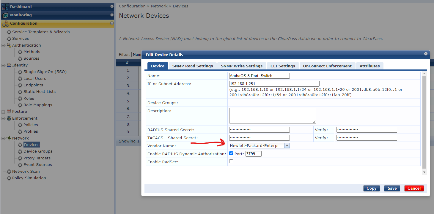

How is your device set up under Devices? Have you tried to toggle between Aruba or HPE?

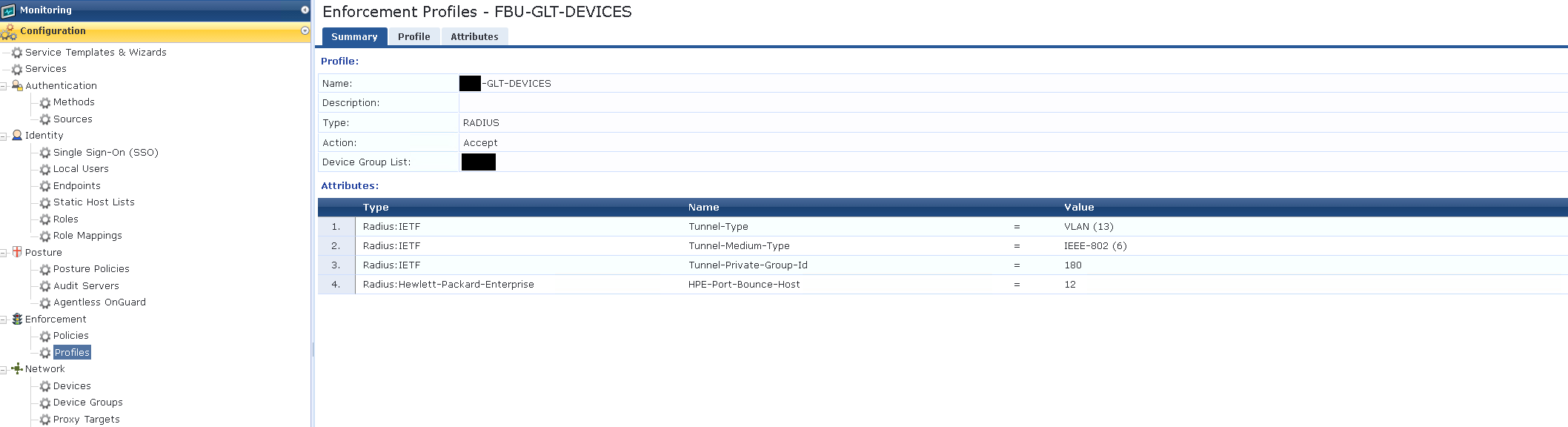

Hello everyone,
I have configured clearpass in the last few days and it works exactly as described.
The policy for the mac authentication which sets the vlan to 180 works.
I still need a port bounce for re-authentication.
Radius: HPE / HPE-port-bounce-host = 12
Unfortunately nothing happens at the switch except that the vlan is set.
Thanks everyone
